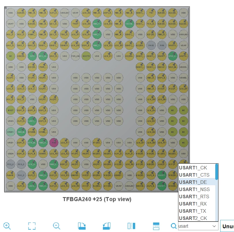

Hie, according to the documentation of the board, USART1 can be used with db9 port by setting up JP7 and JP8 to 1 and 2 ( which I did). The second thing is to connect usart_tx and usart_rx to PB14 and PB15.
The problem is that nothing is showing up on the pc with DB3 port. I've check the tx port with an oscilloscope and I'm getting signal on data sending but only 1.1 V (in AC). I don't know if it's part of the issue but I hope someone has the solution

giorgio29Author
Apr 28, 2026 6:51 AM UTC
First, thank's for the response. I'ce done that because by default when activating the usart 1, tx and rx are setup on PA9 and PA10
I maybe misunderstood something but I'm not supposed to change those settings ? ( nothing is wired on the board )

giorgio29Author
Apr 28, 2026 11:24 AM UTC
Ok I'll clarify.
1 ) I've activated the USART1 in asynchronous mode -> The default pins that were activated were PA9 and PA10.
2) I've changed those pins to match the documention -> The pins are now PB14 and PB15
3 ) I've changed the JP7 and JP8 as the documentation tells.
4 ) After several research, I've put the GPIO Pull up/pull down to Pull up in order to get a 5V output.
5 ) When looking at the tx pin (3rd for db9) with an oscilloscope, I can see data going throught but I can't get it on PC.
6 ) I've tryied several PCs and adapter so no problem there.
Tell me if there is anything not clear enough.

giorgio29Author
Apr 28, 2026 2:44 PM UTC
It is in STM32CubeMx
giorgio29Author
Apr 28, 2026 2:57 PM UTC
Oh sorry, that's the usart clock that I activated on PA8
Andrew Neil
Apr 28, 2026 2:59 PM UTC
USART clock would only be relevant in synchronous mode?
giorgio29Author
Apr 28, 2026 3:00 PM UTC
Sincerely I don't why it solved my issue
Andrew Neil
Apr 28, 2026 3:05 PM UTC
As @mƎALLEm said, it looks like this is just a coincidence - not the actual solution to the problem.
The board only uses PA8 as MCO to optionally clock the Ethernet.
But, hey - it's working now!
