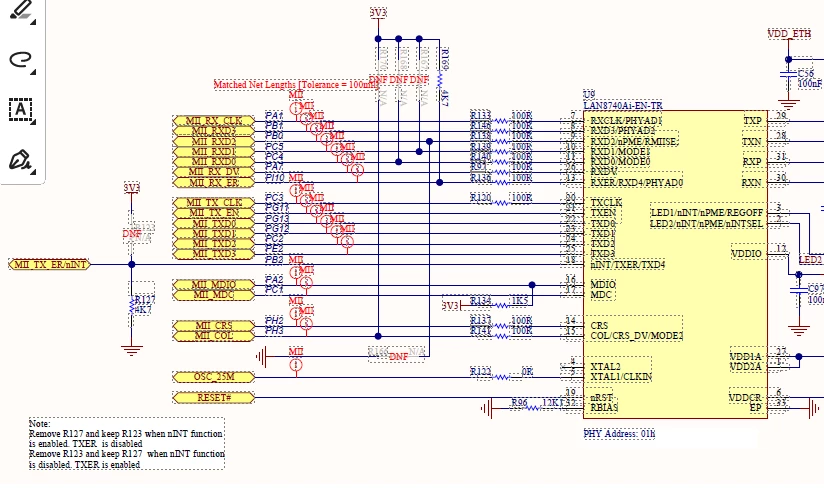

Hello everyone,
I've been working on getting Ethernet working on the STM32H750B-DK discovery board with TouchGFX and LwIP. After extensive debugging, I suspect a hardware issue and would appreciate your advice on confirming this.

> DMA software reset times out
Wait, you say you want to configure MCO to 50 MHz, but are happy with 48 MHz ?
If this is about RMII REF CLK between PHY and STM32: you must have 50 MHz, not only something close to that.
This clock can also be supplied by the LAN8742.
Check the 750-DK schematics if the PHY pin "nINT/REFCLKO" has a pull-up, and check with a scope what's going on there.
And STM32 internally, you should supply the ETH MAC with at least 100 MHz (not 100% sure though).

Given that the working example uses MII mode and my board is the same model, my board almost certainly uses MII mode with the PHY as clock master  (example in https://github.com/stm32-hotspot/STM32H7-LwIP-Examples/tree/main/STM32H750_Disco_ETH). This means:
My 48MHz MCO experiment was misguided (wrong frequency, wrong mode)
PA1 should be receiving 25MHz from PHY, not generating 50MHz
The DMACSR=0 issue is likely due to the descriptor address mismatch we already identified, not the clock

If the PHY is the LAN8742A as on most ST boards, it's surely an RMII interface.

Looking at the board schematics, it indicates MII mode:
MII Signal STM32 Pin Status
ETH_TX_CLKPC3✓ Configured
ETH_TX_ENPG11✓ Configured
ETH_TXD0PG13✓ Configured
ETH_TXD1PG12✓ Configured
ETH_TXD2PC2✓ Configured
ETH_TXD3PE2✓ Configured
ETH_RX_CLKPA1✓ Configured
ETH_RX_DVPA7✓ Configured
ETH_RXD0PC4✓ Configured
ETH_RXD1PC5✓ Configured
ETH_RXD2PB0✓ Configured
ETH_RXD3PB1✓ Configured
ETH_CRSPA0✓ Configured
ETH_COLPA3✓ Configured
ETH_MDCPC1✓ Configured
ETH_MDIOPA2✓ Configured
ETH_RX_ERPI10✓ Configured
