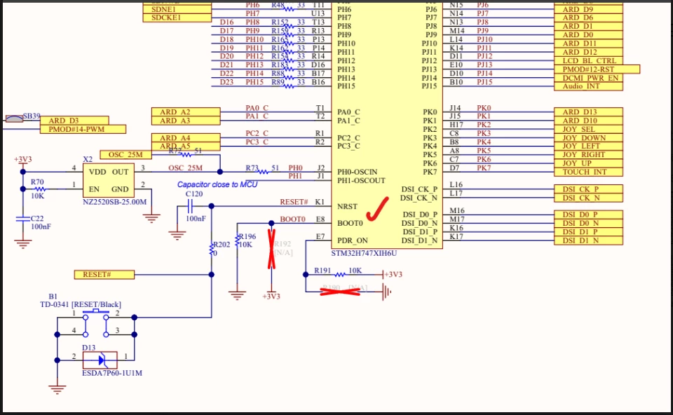

Hi, could you confirm the location of the boot0 pin, where might the boot pin lie on the STM32H747I-DISCO board. I have read the documents but there is nothing mentioned about the boot pin related to dfu, and I have also checked the board, but I couldn't find a dedicated pin or a jumper related the boot pin. In the schematic there is an R192 which connects with the Boot0, do we have to short it? We tried shorting it with a jumper wire but it didn't work. If you know anything about this issue, then kindly let me know about it, thanks.

Starting system bootloader is described in Table 2 Patterns AN2606. And yes R192 is pinout for solder wired button switch or jumper. But as mƎALLEm
USB on this board isnt connected to DFU USB pins. Then for use it you require change board and add connector for USB FS.
Better and simpler is try use one UART based on AN2606 and load firmware  over it and (any USB UART bridge for PC), when STLink isnt ok.

Apr 17, 2025 6:13 PM UTC
According to the AN2606 the pins to be used for DFU are PA11 and PA11 in USB full speed:
But according to the STM32H747I-DISCO board schematic only USB HS is available on the board and PA11/PA12 are used for other purpose:
So unfortunately you cannot use DFU mode with this board.

FBLBest answer
Apr 18, 2025 10:05 AM UTC
Hi @HassaanSaleem-101 @mƎALLEm
You can find an example provided for this board to enter DFU mode using USB HS interface.
However, you cannot access ST's bootloader interface through this HS interface. You need to ensure that bootloader mode is not entered by checking with a tool like STM32CubeProgrammer.
After that, you can adjust USBD_DFU_APP_DEFAULT_ADD, specifying the address from where user's application will be downloaded.
To give better visibility on the answered topics, please click on "Best answer" on the reply which solved your issue or answered your question.Best regards,FBL
mƎALLEm
Apr 18, 2025 10:16 AM UTC
Thank you @FBL I was not aware of that example.
@HassaanSaleem-101
So in conclusion:
1- You cannot use the AN2606 as reference for this board for ST bootloader.
2- You can use the example provided by my colleague @FBL as a "custom bootloader" and no need to use the boot pin in this case.
Did @FBL comment answer your question?
