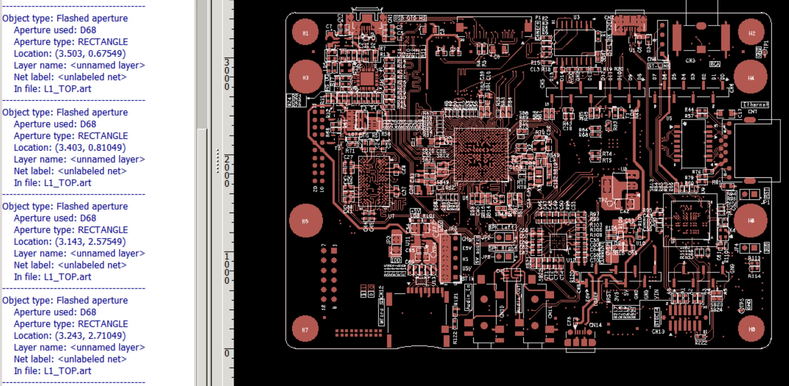

Unfortunately, I am still loosing the needed information. On KiCad, i am not able to open the Gerber Drill files. Get the error message: "Tool 0 not defined".
All I need is the exact position of the CN8 and CN5 and the 4 drill holes for the MB1166.
Would really appreciate your help!
Johannes
August 17, 2021
Open the Gerber files directly with gerbv and you can find individual hole locations.

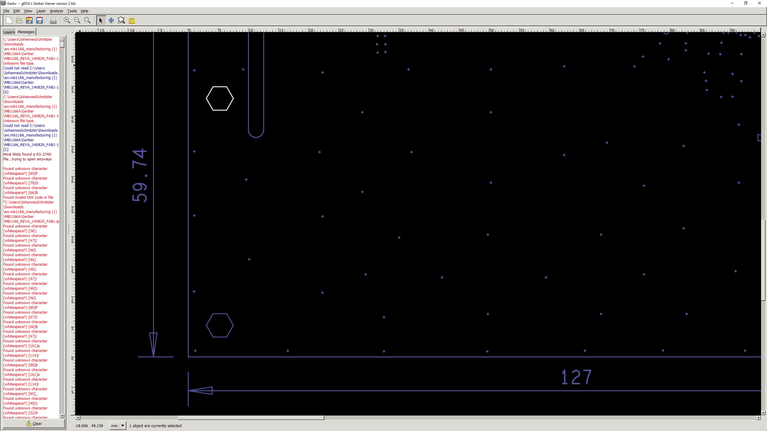

@TDK​ , thanks again for the quick response.
Unfortunately, I can only assume the exact measures, since gerbv does not have access to the properties of the element. See attached screenshot0693W00000D2gNNQAZ.png
August 17, 2021
I’m 100% sure it’s possible to get this info out of gerbv with the appropriate gerber file. But I’m not in a position to do it right now. If you ping me again in a week, I can.

August 27, 2021
The .ART files are the Gerber files to look at. Looks like you are looking at a dimension file.
To center of mass from left side (x=0) and bottom side (y=0):
CN8: 3.453, 0.743
CN5: 3.193, 2.643
I can't find the datasheet for the LCD. The radius is probably in there.
