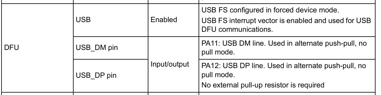

#1 - Can the STM32H747XI on the STM32H747I-DISCO board be put into a DFU mode?
No.
Look at AN2606 to find out which pins are supported by the USB DFU bootloader:
Okay, PA11 and PA12. Then look at the schematic for the board and see which connector they're tied to. They're not tied to a USB connector.
