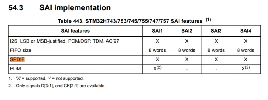

For the STM32H747I-DISCO, we have a SPDIF input connector on the CN3 and  you can confugure the SAI as SPDIF output
for more details, you can take a look at the RM0399 specially the chapter 54 part 4.12.

Quite agree that it's possible to configure the SAI as an SPDIF output.
What I'm pointing out is that the information published on the manufacturer's website is contradictory - it states the DISCO board should have a RCA SPDIF output and it doesn't.
