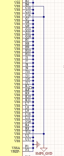

On STM32H747I-DISCO schematic, there are two different grounds. Why is SMPS ground connected to B6, C16 and T12?

Hello @Tycho ,
I'm getting back to you even after a while (receiving a feedback recently from experts) regarding this topic.
Two points:
  1. According to the schematics SMPS_GND and the ground are already connected via SB9SofLit_3-1718287297419.png
  2. According to the board designer the three VSS balls are internally close to some VDDIO33_LDO pins, and consequently, must be connected to SMPS_GND and not VSS as usually, for better signal immunity of LDO and he recommends to follow this rule in your design.
Hope I answered your question.

Andrew Neil
June 13, 2024
@mƎALLEm wrote:
2. According to the board designer the three VSS balls are internally close to some VDDIO33_LDO pins, and consequently, must be connected to SMPS_GND and not VSS as usually, for better signal immunity of LDO and he recommends to follow this rule in your design..
Is that information published anywhere ?
