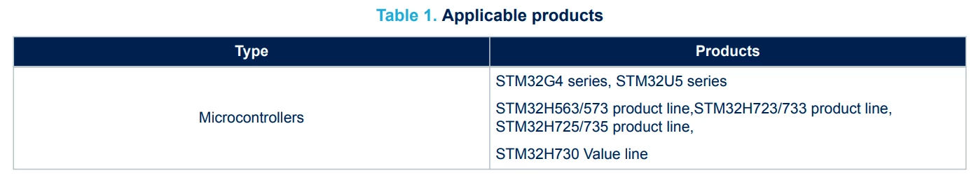

Hello everyone,
I would like to use the CORDIC coprocessor to calculate angles on an STM32H7. The description is in the attached links. However, I have an evaluation board with an STM32H747 (dual core), and I wanted to know if the CORDIC coprocessor is also integrated here.
The reason for this question is that this is not explicitly listed in the PDF in the appendix.
Thanks in advance

The STM32H747 doesn't have a CORDIC coprocessor. See the start of AN5325 for the ones that do.
Tesla DeLorean
Guru
August 1, 2023
No
Officially present in H 720/730, 723/733, 725/735 parts
