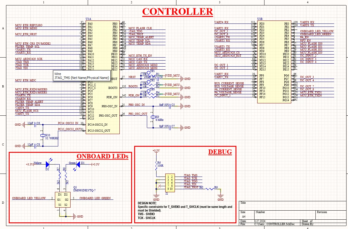

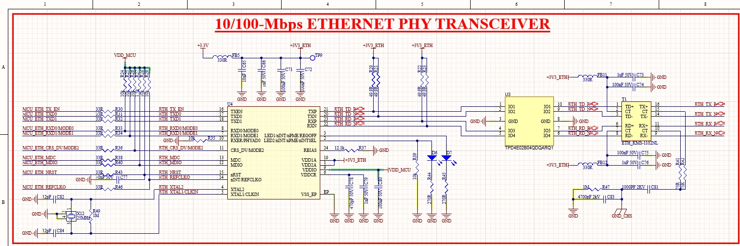

Hi everyone,
I am trying to run an ethernet phy (LAN8742Ai) using STM32H745. I can say that there is no major difference from the Nucleo ref. phy design. However, when i ping, i cannot get a response and the processor gets very hot. The phy and MCU blocks design as follows.
Thank you.

Hello @KTVT ,
After a first examination of the published design here are some findings:
the GPIO configuration is not the same in fact you use:
PG 12 ------->ETH_TXD1
and the ref design of nucleo uses the following pins:
    /**ETH GPIO Configuration
    PC1     ------> ETH_MDC
    PA1     ------> ETH_REF_CLK
    PA2     ------> ETH_MDIO
    PA7     ------> ETH_CRS_DV
    PC4     ------> ETH_RXD0
    PC5     ------> ETH_RXD1
    PB13     ------> ETH_TXD1
    PG11     ------> ETH_TX_EN
    PG13     ------> ETH_TXD0
The oscillator configuration used in you design is not the same in the nucleo board, so I recommend you check if the PHY is clocked correctly by visualizing signals of Ethernet Ref clock and make sure you are getting the 50 Mhz to the MCU.
you use TPD4E02B04 before going to KMS-1102NL i don't get why you added this ESD protection which according to its datasheet is suited for:
Interfaces
– USB Type-C
– USB 3.1 Gen 2
– HDMI 2.0/1.4
– USB 3.0
– DisplayPort 1.3
– PCI Express 3.0
and not for Ethernet
regarding the high temp issue, you are motioning we need some more insights it you RCC and smps ldo and other power related and clock related hardware insights and software to help you further
regards
Pavel A.
August 27, 2024
Will the STM32 become hot if you don't enable ETH and PHY and instead run something else (LED blinky)?
