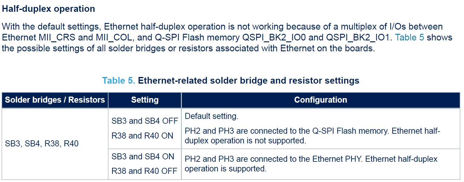

STM32H745XI Discovery and Ethernet physical connection

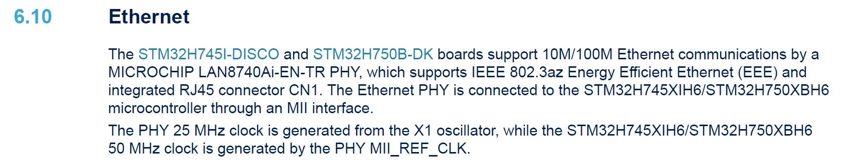

I am trying to use Ethernet with STM32H745XI Discovery board and try to find out, if default board configuration can be used or I need to redirect Q-SPI to pints to Ethernet. Unfortunately the documentation description is not clear - should be this done or should be this done only for Half-duplex operation. Is it possible to use RMII configuration?, in documentation has been written - it is connected with MII, but Microchip PHY support also RMII.
I am not hardware guy and have never worked with Ethernet previously.
So the 2 main question:
  • should I do a board rework according to specification, because Ethernet will not work
  • Can I use RMII configuration
Thank you in advance.
Documentation reference:
Best regards, Dima

Hello @DSvit.1​
Q-SPI and ethernet share some pins even when using RMII. Therefore, it wouldn't be possible to use ethernet without following the application note instructions.
BeST Regards,
Walid

Hi Walid,
Get it worked !!!, thank you very much
Best Regards, Dmytro
