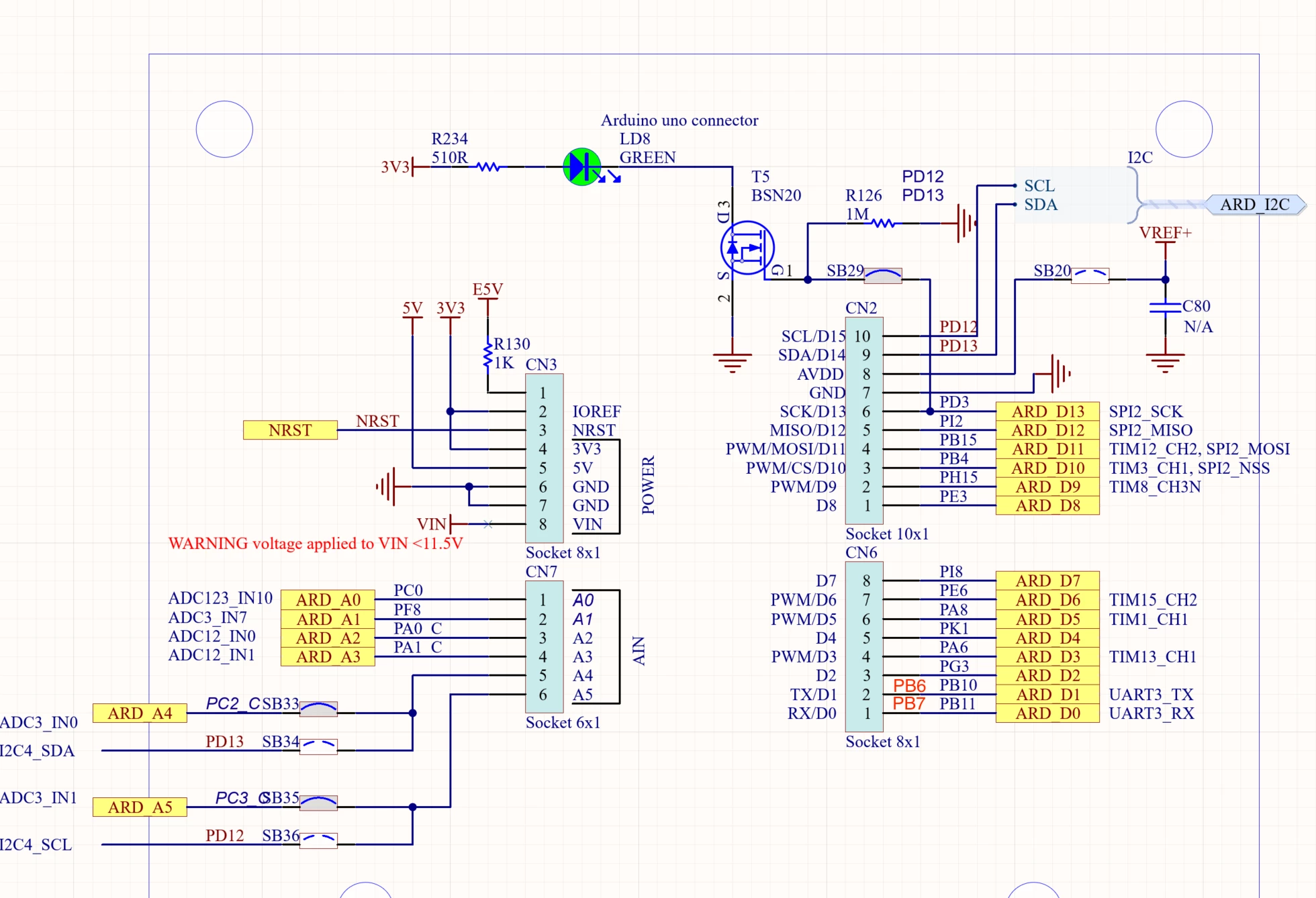

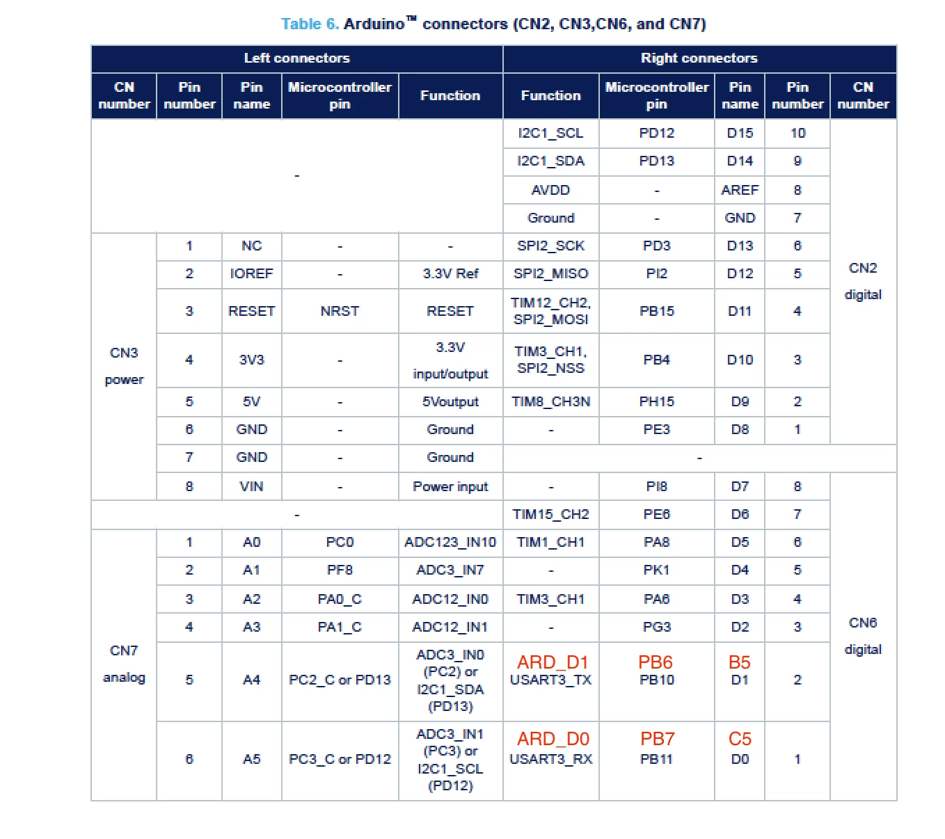

We are working with the STM32H745I-DISCO and a custom daughter board we designed that interfaces with the Arduino Style Connectors on the DISCO Board.  We believe that there are errors on both the Altium Source Schematics and the UM2488 (Page 16) for the labels and documentation of CN6 Pins 1 and 2.  I am attaching copies of a page from both sources showing the original labels and our redline corrections.  We traced these signals on the PCB route to verify our corrections are accurate.  ST should really correct this as we spent a good deal of time incorrectly assuming the documentation for these signals was accurate!  This will help save others from going down the wrong path!

The document you have mentioned is an old revision. So, I think it was an error on this version that have been solved on the next versions (Solved on REV4 of the UM2488). You need to always use the last version of each document.
For the design of both rev B01. I can confirm the typo that will be escalated internally for correction (under internal ticket number 177155).
Thank you again for reporting this.

The documentation you point us to has (in the title block) Ref MB1381, the Variant H745XI, Revision B-03, and the date of 6/2/22.  The previous UM2488 documentation (and Altium files) we downloaded from the ST website has the same Ref#, but Revision B-01, No Variant, and date of 6/11/18.
The PCB assemblies we have are marked MB1381-H745XI-B01 (and -B02).  The B01 and B02 hardware we have seems to agree with the B03 newer documentation you are pointing us to (CN6 pins 1 and 2 connected to PB7 and PB6 respectively), but the documents that say B01 (see attached) have those CN6 pins 1, 2 and two assigned to PB11 and and PB10 which appears to be incorrect.  This is why we are confused.
