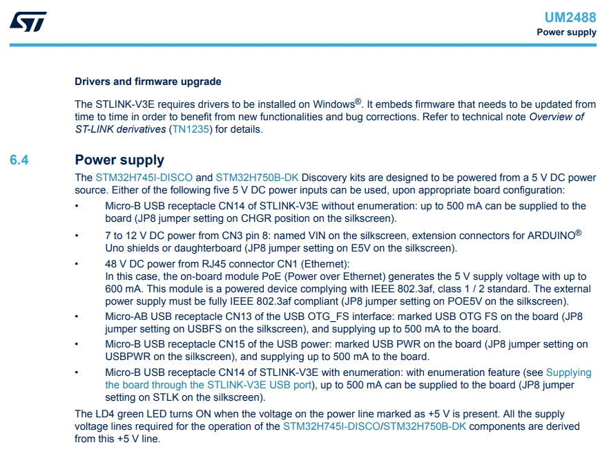

Andrew Neil
Mar 18, 2025 9:48 AM UTC
Sounds like the connector's broken?
Have you tried powering the board through any of the other options?
https://www.st.com/resource/en/user_manual/um2488-discovery-kits-with-stm32h745xi-and-stm32h750xb-mcus-stmicroelectronics.pdf#page=11
