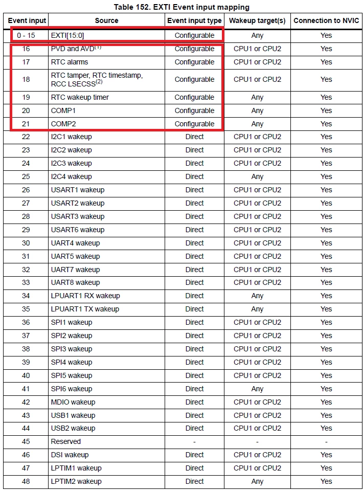

STM32H745 EXTI and SYSCFG_EXTICRx relation
   I am trying to better understand the relation of how the SYSCFG_EXTICRx and the EXTI_RTSR1 registers correspond. In the manual as I understand, the SYSCFG_EXTICRx registers are used to setup a pin on the EXTI line for interrupt use by setting your desired port config. Looking in the manual at the EXTI_RTSR1 register, I believe the 0-15 bits are used for the corresponding lines that the SYSCFG_EXTICRx register sets. However, there is bits 16-21 which if anyone knows what or how they are used?
   Any clarification would be appreciated. I am just trying to clarify my understanding is correct and what these other bits are referring to.
Thanks

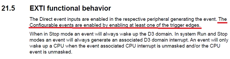

The EXI lines are not only used for pins but also to be triggered by internal signals:
See "Event input type" in table 152. If it's configurable, there is a corresponding bit in EXTI_RTSRx registers.
See table RM0399/ Table 152
Hope it does answer your question.
