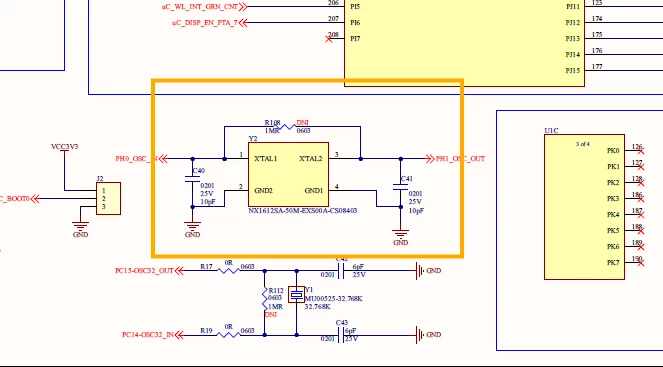

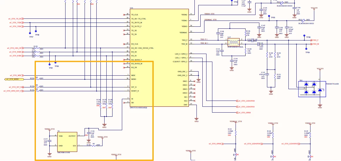

Hello, I am using STM32H743BIT6 as a MAC for DP83TC814R Ethernet PHY, I have one query regarding oscillator, I am using Ethernet in RMII slave mode which requires 50MHz reference clock, can i use the same clock which i am using for MCU HSE or should i use different one for EThernet PHY, But how the clocks can be synchronised in that case?

Yes you can use the same clock (50MHz is the max clock allowed on OSC_IN), the synch is via the RMII_REF_CLK input pin of the STM32H7 (50MHz from PHY).

MAC part number : STM32H743BIT6
PHY part number : DP83TC814R

I will no do your work, please read the Datasheet / Reference manual for the STM32H74x and the DP83TC814.
Some small hint: The STM32 MAC with RMII interface needs the same clock as the PHY, see chapter 58.6.3 of the Reference manual (rm0433).
