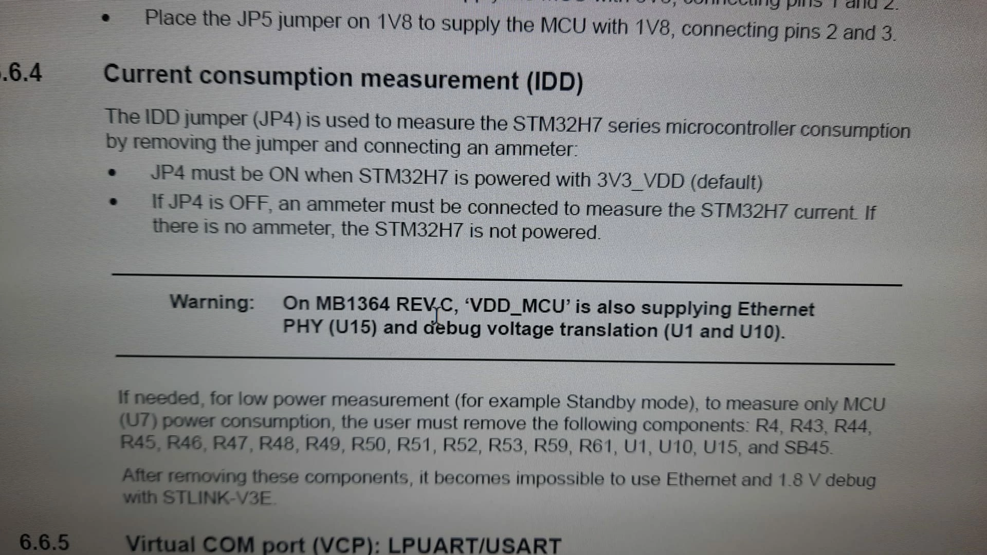

Stm32H723 Stop mode high current 4mA !!
Hi all,
I am using the Nucleo-H723ZG board and I'm testing the consumption in stop mode, running the example from the ST repository NUCLEO-H723ZG\Example_LL\PWR\PWR_EnterStopMode.
The code compiles without any warning and I use the stlink of the nucleo to program it.
I removed the Jumper JP4 (VDD_MCU) and in its place I inserted a precise ammeter (HP34401A)
The current measured at the moment of STOP is about 4mA!!
Can anyone help me?

I found the solution...
Many thanks to everyone.

AScha.3
Jan 31, 2025 3:46 PM UTC
so look at the circuit of the board to see, what still is connected - and check, that you switched it off.
https://www.st.com/resource/en/schematic_pack/mb1364-h723zg-e01_schematic.pdf
btw  4mA ...still driving a LED ? :)

Andrew Neil
Jan 31, 2025 3:56 PM UTC
@NMast.1 wrote:
The jumper is actually made to measure the current of the MCU.
But that will include any current sourced from the MCU;  whether intentionally, or by "leakage" to other stuff on the board - such as the ST-Link.
See the link I posted earlier.
