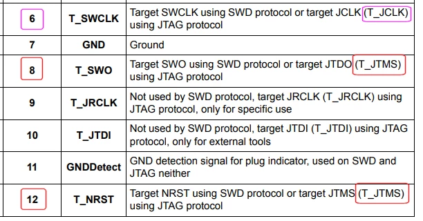

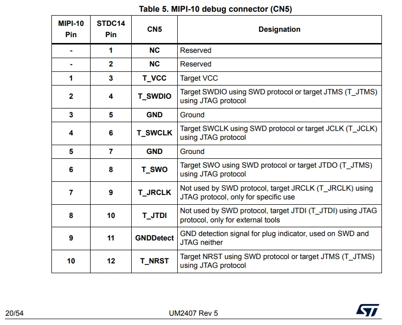

Table 5 on Page 20 of UM2407 contains erroneous info on the STDC14 connector. I am very sure that the descriptions for STDC14 pins 8 and 12 are wrong, maybe others aswell.

So this:
Yes ?
So, as @mƎALLEm said, what do you think is wrong, and why?

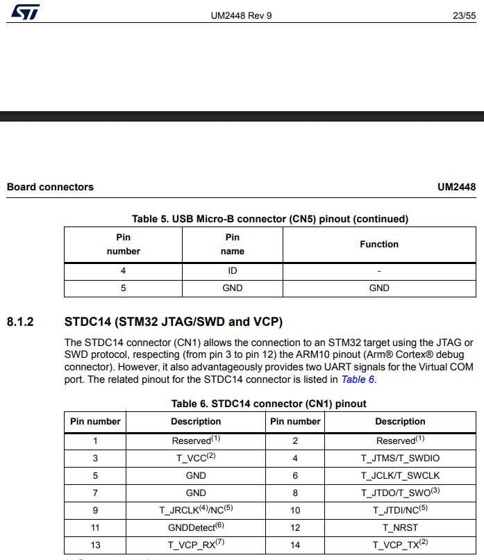

PS:
It seems to match the STDC14 pinout shown in the STLink-V3SET manual:
https://www.st.com/resource/en/user_manual/um2448-stlinkv3set-debuggerprogrammer-for-stm8-and-stm32-stmicroelectronics.pdf#page=24

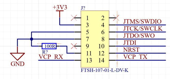

According to the designation column, pin 6, 8 and 12 are targeting JTMS(T_JTMS), JTDO(T_JTMS) and JTMS(T_JTMS) respectively. As far as i know that is wrong, as you are not supposed to connect them all to T_JTMS and pin 12 needs to be connected to NRST for JTAG to be able to force reset during debugging to regain control of the MCU. I mean i know i could just follow the CN5 column of the table, but the designation column confused me alot.
Edit: when talking about pin numbers im looking at the pin numbers in the column stdc14.

@KasDev wrote:
According to the designation column, pin 6, 8 and 12 are targeting JTMS(T_JTMS), JTDO(T_JTMS) and JTMS(T_JTMS) respectively. .
8 & 12 are both T_JTMS, but 6 is T_JCLK:
So it does look like 8 is wrong?

A jumped in the columns, i meant 4, 8 and 12.

Dec 18, 2025 1:16 PM UTC
No, i just copied this from a colleagues schematic who claimed it worked in the past and moved on.
Just wanted to give you a heads up.

I think how this it should be:
While pin 4 description is correct
Internal ticket for follow-up 224078.
