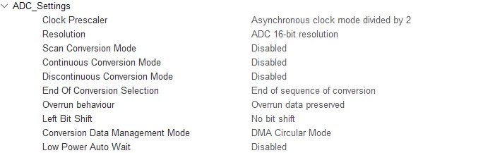

ADC Settings:

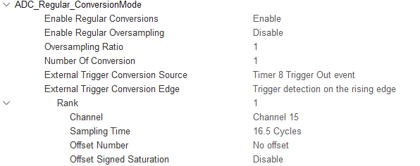

ADC Regular Conversion Mode:

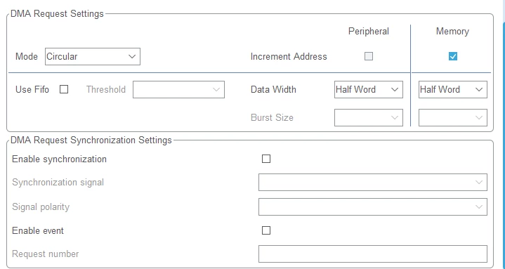

DMA Settings:

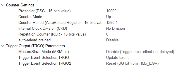

Timer Settings (this enables 10Hz timer with 138 MHz APB):

I have also seen this post (https://community.st.com/t5/stm32cubeide-mcus/hal-adc-convcpltcallback-only-called-once/td-p/637221) featuring similar problems and solution. This post uses "TIM auto-reload preload: Enable", different than the YouTube guide, but neither solved the problem.

This ended up being a very *** bug. My adcData is defined as
volatile uint16_t adcData;
So the DMA setup should be
HAL_ADC_Start_DMA(&hadc1, (uint32_t *) &adcData, 1);
 instead. I missed the reference...
