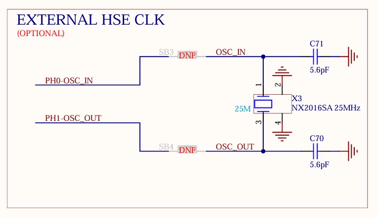

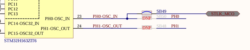

> Nucleo STM32H563ZI board
> Nevertheless if I change the main clock source to the 24Mhz crystal
The default clock configuration is a HSE bypass signal of 8 MHz coming in from the st-link chip.
If you close a few different solder bridges, the board has a 25 MHz crystal, not 24 MHz.

Hi, you're right. I've forgot that I'm working on a DEV board.
So basically setting the RCC to Bypass Clock Source, the HSE to 8Mhz and the USART clock mux to 250Mhz (and the HClk also to 250Mhz), every thing works as it should.
