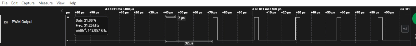

  • I'm trying to generate PWM signal using [ TIM3 channel 3] in NUCLEO-G071RB Eval board.
  • Time period is 28 microseconds and width are 3 microseconds.
  • As you can see in the below [image 1 ]only the first pulse is different or corrupted, which gives 32 microseconds time period and width are 7 microseconds .

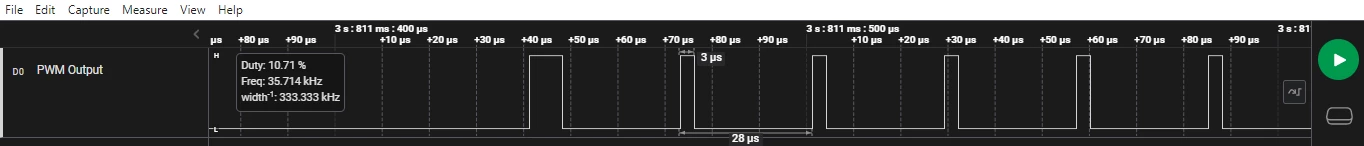

  • From the second pulse , we are able to get the expected pulse as shown below [image 2] Time period is 28 microseconds and width are 3 microseconds.
  • Same behaviour is observed in STM32Cube_FW_G0_V1.6.0 package code, given by STM32 Timer PWM output example code.
Please provide the solution to resolve this issue.

Hello @waclawek.jan, @Denial1, @TDK,
This behavior is now noted in Readme files of all HAL TIM examples calling HAL_TIM_PWM_ConfigChannel() with the output channel configured in PWM1 mode:
TIM_6Steps,
TIM_Asymetric,
TIM_CascadeSynchro,
TIM_Combined,
TIM_ComplementarySignals,
TIM_Dithering,
TIM_DMA,
TIM_DMABurst,
TIM_ParallelSynchro,
TIM_PrescalerSelection,
TIM_PWMOutput.
The note is the following:
In this examples, the output channel is configured in PWM1 mode meaning that in up-counting mode, channel 1 is active as long as TIMx_CNT < TIMx_CCR1. As, in the function HAL_TIM_PWM_Start* function, the output channel is enabled prior enabling the timer's counter a timing difference might be observed on the first generated PWM. This difference corresponds to the delay - in term of number of CPU cycles - between the channel enable and the counter enable in the HAL_TIM_PWM_Start* function.

Hello @Denial1,
Are you overwriting the CCR register directly? Have you seen this behavior after changing the pulse width from 7us to 3us?

October 11, 2023
Probably the first pulse starts before the timer is started.
A solution would be to set the CNT of the timer to a value which produces a low state on the pin, rather than a high state. Perhaps set to ARR-1 instead of 0 during initialization. Or otherwise ensure the output state is low during initialization.

@Sarra.S,
From the waveform capture it's not clear whether the leftmost pulse was the first one after reset (and I am afraid it wasn't).
@Denial1,
CubeMX with Cube/HAL provides a quick clicking solution to generate PWM but perhaps does not pay much attention to details like this. If you want anything outside of what the Cube/HAL authors deem usual usage, Cube gets into way more than helps. TDK gave you above the explanation for your problem and also a suggested remedy, just follow his recommendation.
