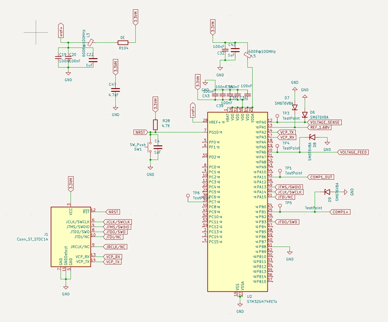

Hello, I am using the stm32g47ret6 microcontroller and I am having troubles with transmitting and receiving data using the USART2 to my PC through the ST-LINK V3-SET. If I understand correctly, I left the v3-set configured as default (did not change the jumper configurations). I used MX to configure the usart2 module and used vcp_rx and vcp_tx for communication, used the pins PA3 and PA2 and also configured them in MX. I checked the baud rates, COM Port in my device manager. I am using tera term 5 to read the data, but I get a blank screen every time I start the program. To debug this, I tried probing the pins using an oscilloscope and I do see some repeated pulses, the baud rate matches and Uppercase 'U’ does give a square wave. I also checked the UART transmit status which shows HAL_OK in live expressions in the CUBEIDE. I am using a custom hardware board with the stm32g474ret6 mcu, it is connected to the st-link via the stdc14 connecter. This is the schematic for it.

In particular, what board are you using, and how is it connected to your STLink ?
Show your schematic; Some good, clear photos of your setup could help.
Before adding the complications of an external STLink, have you got this working on a Nucleo board (or similar) with built-in STLink, using a standard ST example?
Are they valid UART frames, with the expected format, at the expected baud rate ?
For easier scope triggering, just send a single repeating character - Uppercase ‘U’ is good, as it gives a square wave...

I am using a custom hardware board with the stm32g474ret6 mcu, it is connected to the st-link via the stdc14 connecter. This is the schematic for it. I also checked the baud rate and Uppercase 'U’ does give a square wave.
Before going to a custom board, have you got this working on a known-good ST board?
Have you tried a separate, known-good UART-to-USB converter?
Have you tried a loop-back from your TeraTerm, through the STLink, back to TeraTerm?
How, exactly, did you do that?
With correct framing, baud rate, etc ?

In your question I miss the connection from PA3 and PA2 to your PC?
You will need some UART/USB converter probably, since PA2 and PA3 are 0/3.3V level.
