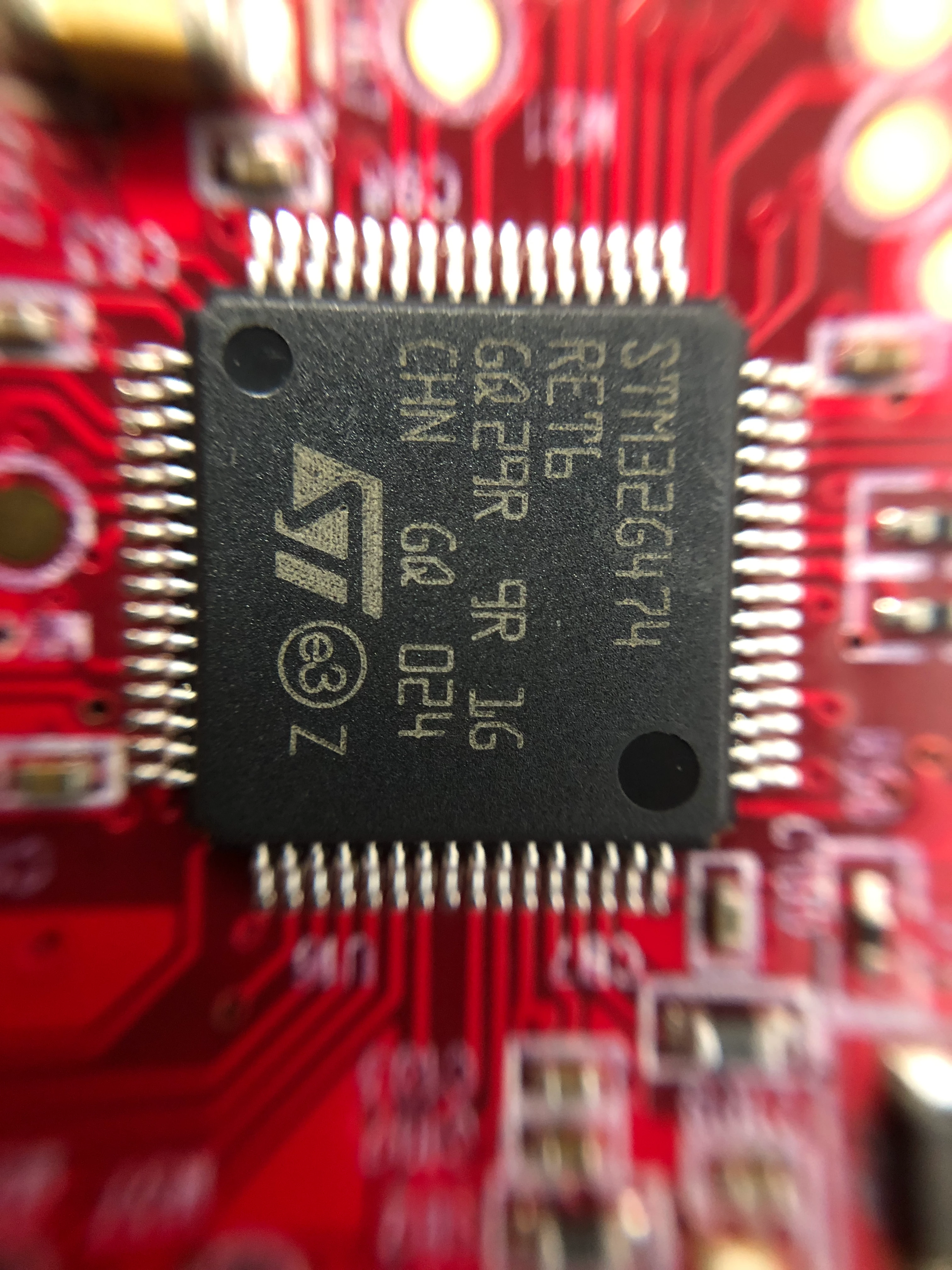

I have questions about STM32G474RET6. I have 25 MCUs in my hand. After SMD and power on, I found some abnormal conditions. Then, I swap the MCU (NUCLEO-G474RE and my PCB) and use the same firmware, the MCU can work normally on my PCB.

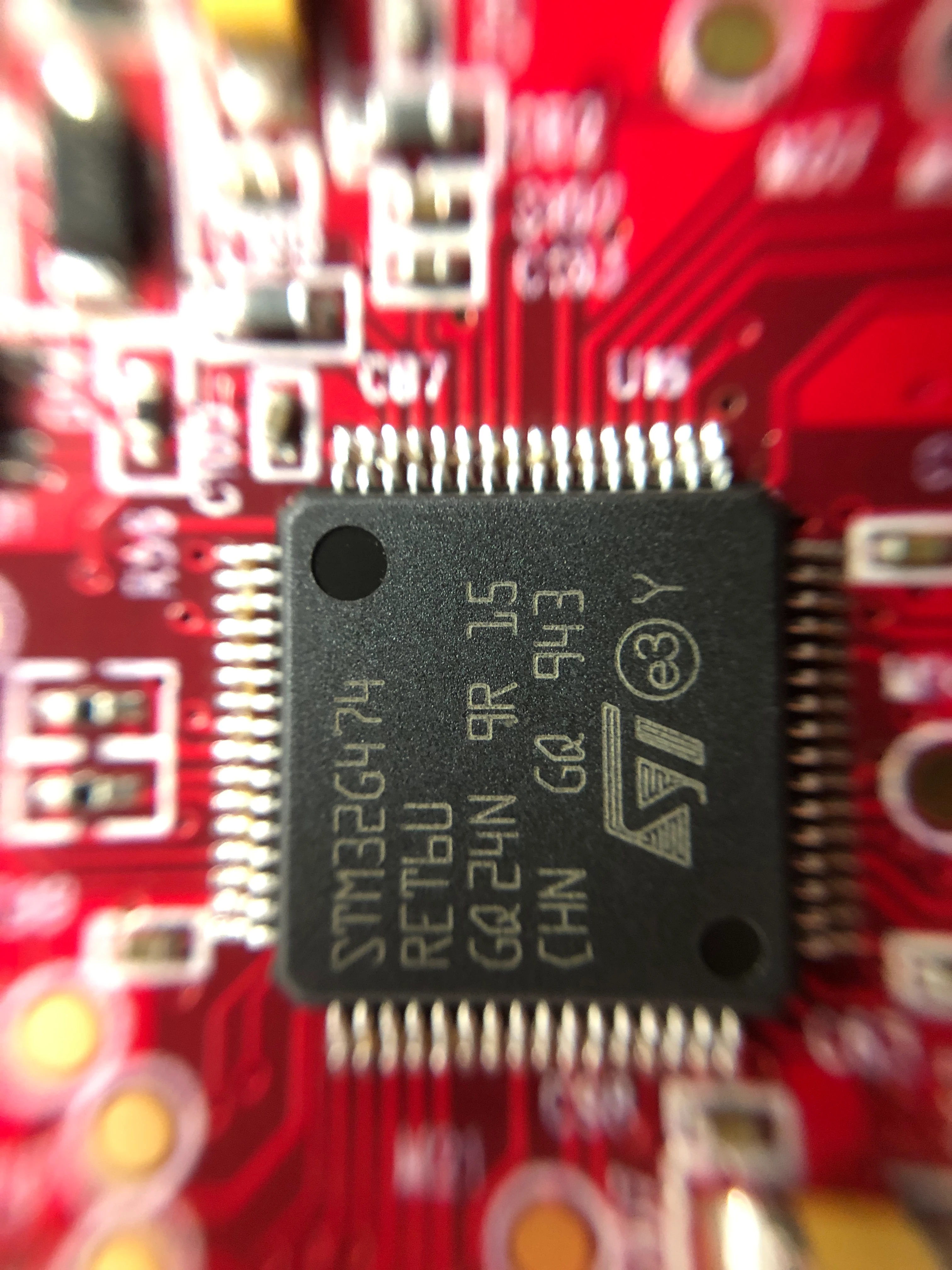

  1. I took two MCU pictures, one was used in NUCLEO-G474RE, and the other was purchased from MOUSER. You can find some different information in the product identification. At NUCLEO-G474RE, the product identification show "STM32G474RET6U" and revision code is "Y". At my MCU (from MOUSER), the product identification show "STM32G474RET6" and revision code is "Z". Can you explain what different at there two MCU ?0693W000005CqZMQA0.jpg0693W000005CqZ2QAK.jpg
  2. Continue to question 1. If these two are the same, why my MCU cannot work on my PCB but NUCLEO's MCU can work on my PCB ? If these two are different, how to confirm that the MCU I bought is correct and working?
Revisions are typically made to correct hardware issues. You can find out the known issues by reading the errata sheet, which notes which ones have been fixed in which revision.
https://www.st.com/resource/en/errata_sheet/dm00500968-stm32g471xx473xx474xx483xx484xx-device-errata-stmicroelectronics.pdf
No silver bullet here. Could be a hardware issue. Look like there could be a solder bridge on the top-left on the bottom picture. Inspect power rails, step through code to find issues.

November 27, 2020
The Y revision has an incredible amount of _2_ issues fixed w.r.t. Rev Z. Both are ADC issues.
waclawek.jan
November 27, 2020
The U suffix is used to mark, that licence fees have been paid for software which accompanies the related Nucleo board. That has no relationship to functionality at all.

Hi WLai.1 ,
Both devices differs only in limitations described in erratasheet.
What is exactly the problem which is present in the device with Revision Z ?
