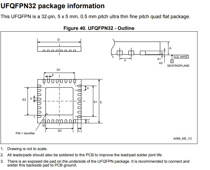

STM32G431KxUx exposed pad of UFQFPN-32pin package, connect it to GND or leave NC ?
Sarra.SBest answer
March 1, 2023
Hello @MFatt.1​ and welcome to ST Community,
As mentioned in the datasheet :
0693W00000aHvnwQAC.png>> There is an exposed die pad on the underside of the UFQFPN package. It is recommended to connect and solder this back-side pad to PCB ground.
Hope that helps!

Thanks.
