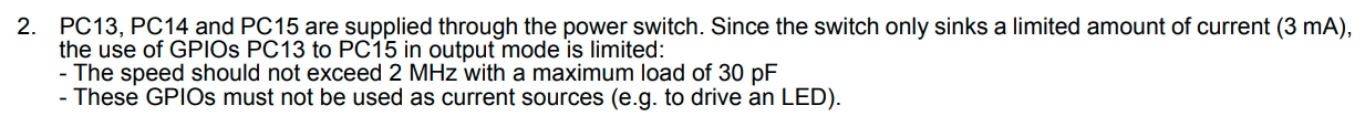

December 21, 2021
Note that PC13-PC15 have limited driving capability.
