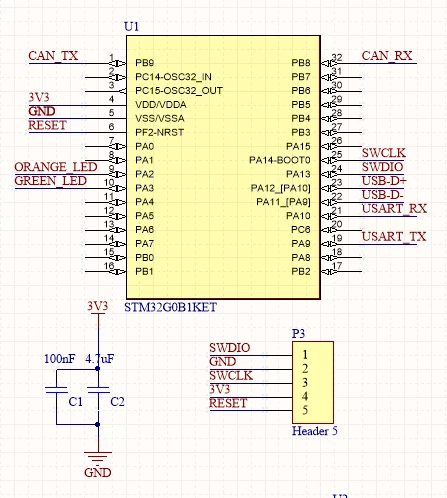

I designed and assembled a simple circuit around the STM32G0B1KET and after connecting my ST-link it does not seem to "boot". My circuit looks like this:
Additionally, there is a red LED through a 330Ohm resistor connected to 3.3v
I am powering from the stlink device for now, but the design has a voltage regulator. But I've only assembled these critical components to make sure it would work - and it doesn't.

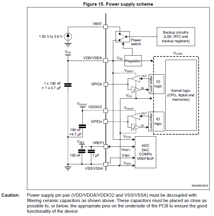

I've followed the datasheet with regards to the loading capacitors:
on this MCPU there aren't specific pins for VREF, VDDIO, or VBAT.
Did I miss something somewhere?

By "boot" you mean
a) cannot connect ST-LINK debugger on a virgin chip
b) after successful programming via ST-LINK, doesn't boot from flash
c) ???
hth

ST-link on a virgin chip does not detect the chip. The ST-Link utility claims it cannot connect to target.

ST-LINK Utility is OLD, might not support G0, use STM32 Cube Programmer.
For an authentic/classic ST-LINK/V2, make sure target voltage is supplied to pin 1 or 2 of the 20-pin header.
Connect a 1-4 MHz SWD clocking, the CM0(+) devices typically don't like high MHz rates.
If still not capable of detecting, check part orientation and power.
Check the state of the NRST line in nominal power condition.

First, my problem wasn't with my circuit or assembly. A couple days ago my STLink V2 programmer died (the little usb ones), and I overnighted a new one. However, I could not get it to work either. Finally after fighting with it, I was able to upgrade it and program the processor! A secondary problem I was having is that Keil would not program the processor, so I thought it wasn't working. I instead, created the project with stm32CubeIDE, and successfully programmed.
