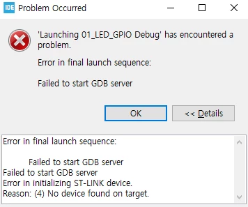

STM32G071RBT6(Reason : (4)No device found on target.)

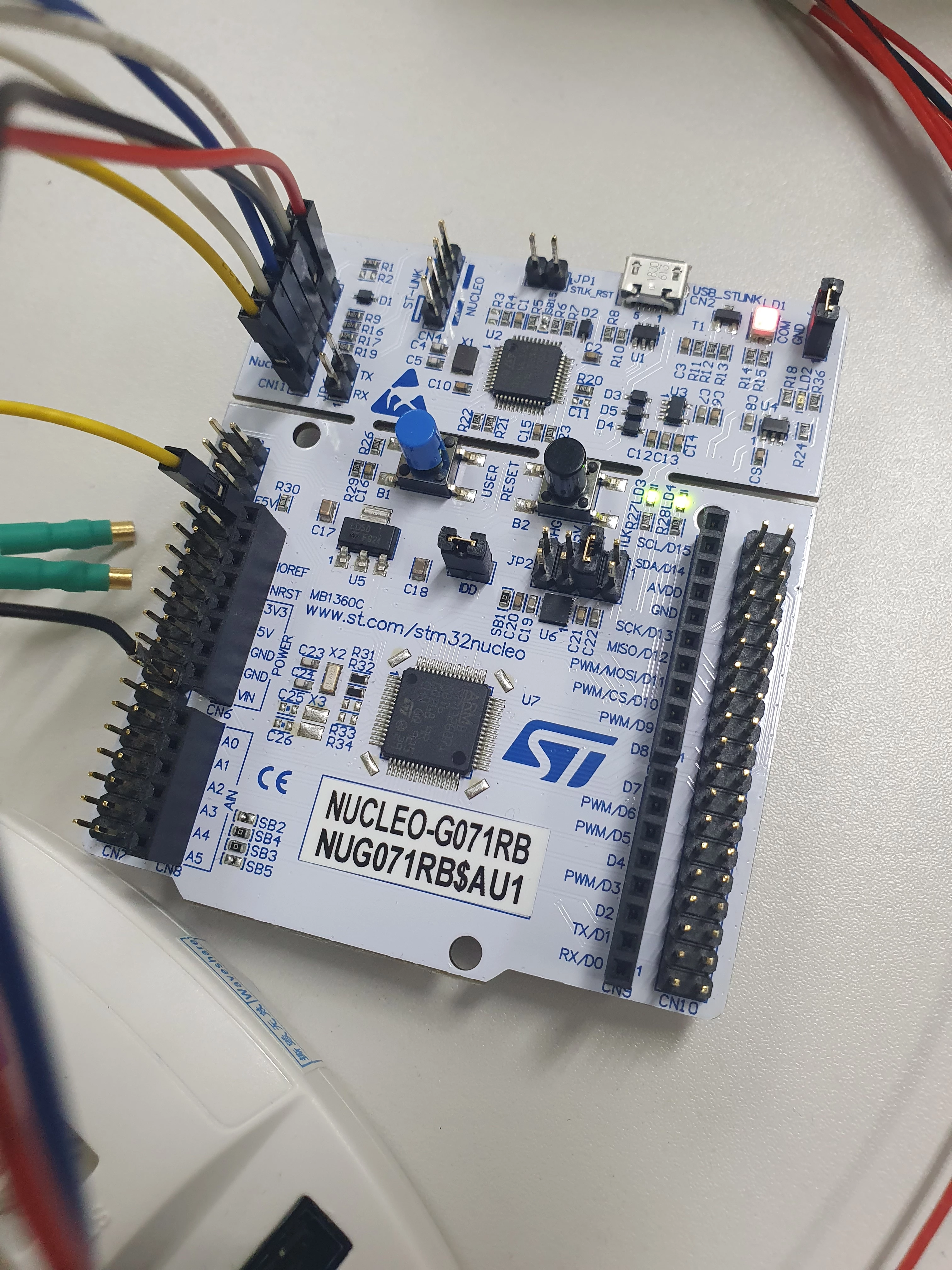

I have the following problem when using the Nucleo board.
I do not have a mini-usb.
So I use to ST-LINK.
However, the following warning message is displayed.
Please tell me the solution.
Thank you for reading.

check that gnd, swdio, swclk lines are correctly shared between stlink and MCU. use a multimeter to check​

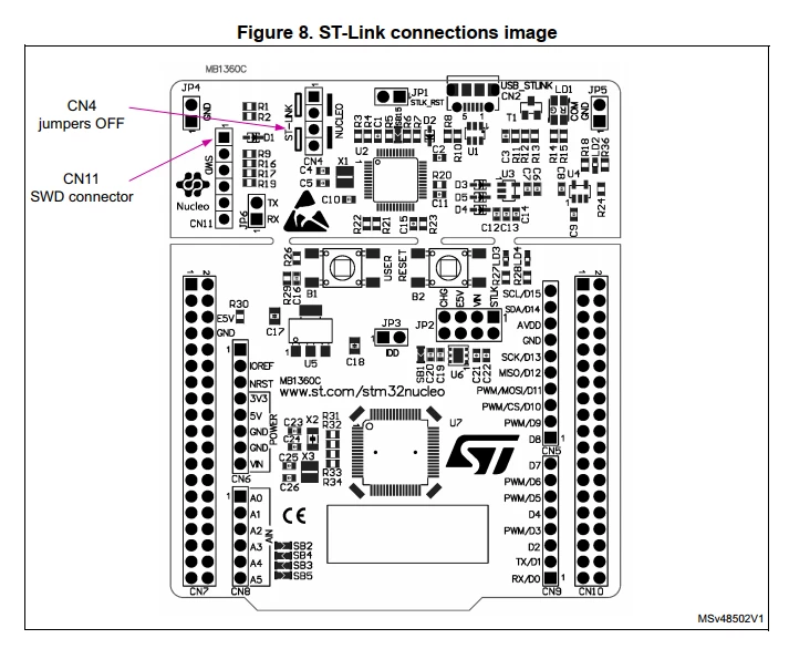

I linked it like the datasheet below.
but it isn't operation.
CN11
1 - VCC
2 - SWCLK
3 - GND
4 - SWDIO
5 - RESET

That's for OUT-BOUND connectivity.
Review the schematic, understand the circuit..

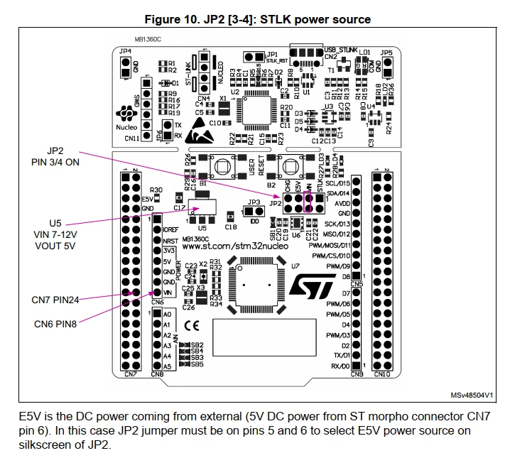

Check you power supply. I would suggest connecting to VIN not VDD directly.

Can't in-bound SWD connection via that header, not how it works.
