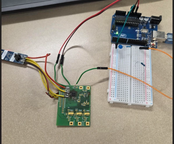

While designing Electronic speed controllers for a 6s battery, an stm32 was decided to use as the MCU.
After receiving our first PCBs, we were unable to successfully program them with the stlinkv3 minie. Attached is an image of the schematic of where the STM lies on the board as well as the attached components. When the boards first came in the stm32 was able to be flashed with a program, but after the first flash they could not be connected to any more. This is with using an external power supply as the stlink v3 didn't seem to provide power as the prg tool was unable to detect the chip.
After continued testing (and changing out the mcu) the issue persisted although with a slight deviation, it would allow us to program it once or twice but when we clear the flash, it would lose connection and throw an error of dev_target_held_under_reset. In case it is relevant, the only connection type that can even read the flash of the chip is hot plug but that is unable to change the data as far as I am aware.
Trying to alleviate this issue, the reset decoupling capacitor was removed in case there was something causing a short, as well as a blank pcb being used with just the microcontroller and capacitors included. Still no luck. In case it was the program that was being applied, the program was changed to a simple blink program, however, even this will not work. We have 2 different layout/schematics for two different tasks that both use the same microcontroller and neither of them are able to program. Either the program tool says no stm32 found, or it says that it is held under reset. I have searched many forums and have not found any solutions that work, including using a 10kOhm resistor from 3.3v to the reset pin in case the internal pullup was not providing enough power to the pin. None of these solutions work. The original software (bootloader and firmware of AM32) works on a nucleo test board with the same steps used to program the custom pcb and the same microcontroller (although different package, they are both 128k flash g071).
This is very frustrating as we have not been able to even test the hardware that we have designed for the past 2 months as we have been stuck trying to program the boards for so long. Any help or solutions that could be provided would be absolutely lovely. The layout of the microcontroller for one of the PCBs is also provided with the reset path highlighted. (Continuity of all of the paths has already been tested and there are no issues in that respect.

Is there a common ground between the board, the programmer, and the power supply? Show a picture of this.

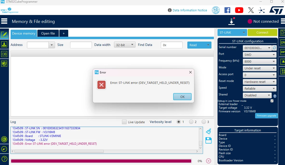

Does the programmer report the correct target board voltage? Show a full screenshot when you try to connect.
Feb 2, 2026 7:46 PM UTC
Yes, All three grounds are connected, im currently out of the lab and using an arduino as a power supply, not the most elegant solution, but it is what i used when programming the nucleo board. If you think its because of the arduino... I can go to the lab in about 45 minutes and send a screenshot from there, but the voltage on 3.3v is 3.3v, and the arduino can deliver more current than the mcu should take.

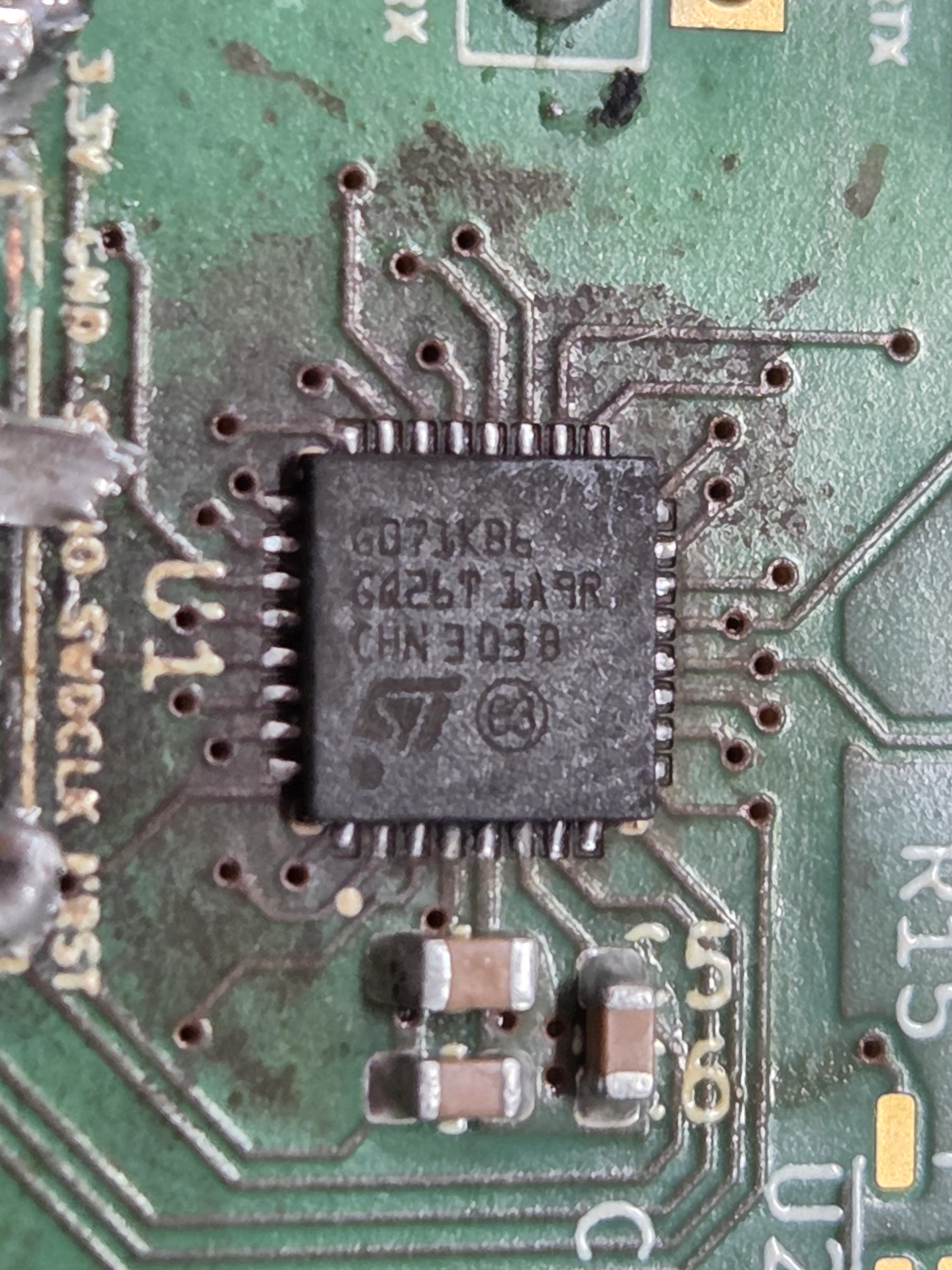

Also, the black around the microcontroller is from the flux that we used, it was old and discolored the soldermask.

This is likely a hardware issue. If NRST is stuck low, the chip may not have sufficient power. There's nothing wrong with this setup in theory.

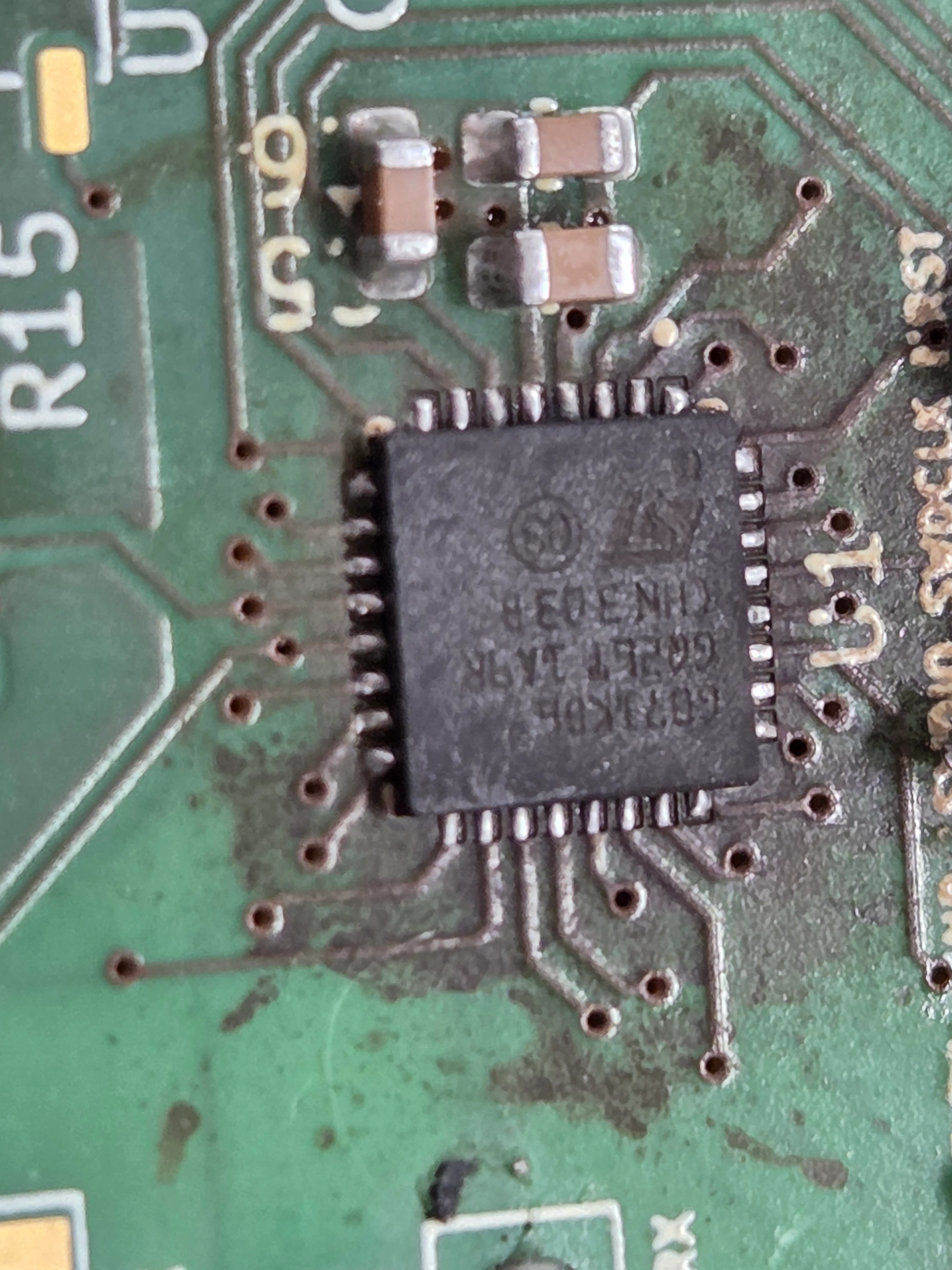

Is the chip oriented correctly? That picture isn't close enough to tell. Pin 1 is bottom left when text reads from left to right. If you can, post a clear, large, in-focus of the chip itself and surrounding solder joints.
Turn your soldering iron down. The flux should not be discoloring that much, even if it's old.

The  pcb software add3d an alignment dot to the silkscreen, that dot is lined up with the dot on the chip, so, im sure it is orientated correctly, also, since it was able to program twice before stopping i dont believe this is the issue.1000005458.jpg

It looks a bit like BBQ, sorry.
Maybe it got damaged while soldering?
Feb 2, 2026 8:05 PM UTC
While that is possible, the same problem has happened with multiple chips. The ic was installed with hot air gun set to 400f, this issue has persisted across 4 different stm32s that are across different pcbs, though ive used 2 on this pcb.

Orientation looks correct.
Capacitor solder joints look good.
Presumably the STM32 solder joints are okay too. Looks better than I was expecting from the first picture.
400 F is a good temp for leaded solder. The capacitor joints look good so the temperature is probably good even if the "400" setting is off.

dev_target_held_under_reset error usually means your code is reconfiguring the SWD pins as GPIOs or hitting a low-power mode the second it boots.
Since you can only see it in "hot plug," you need to jump into CubeProgrammer.
There set your Connection Mode to "Under Reset" with the Reset Mode on "Hardware Reset" to catch the core before your firmware locks the debugger out.
Double checking your power as well. if you're really drawing 70mA while idle with the programmer, you've likely got a microscopic bridge or a latch-up on that discolored PCB that's causing the flash mass erase to fail mid-cycle.
Feb 3, 2026 5:13 PM UTC
I have tried the connection stuff you mentioned, if you look in the original screenshot of the programmer those are the settings being used. As far as a bridge, that's possible but I'm not sure where it would happen, I've checked the wires multiple times and there were no shorts/
