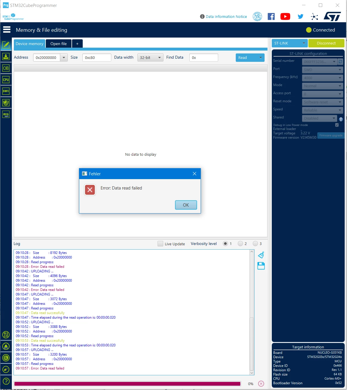

We've got here 3 STM32G031K8 Nucleo. 2 of them had problems with RAM access. 1 works fine at the moment.
For example STM32CubeProgrammer shows by RAM Dump

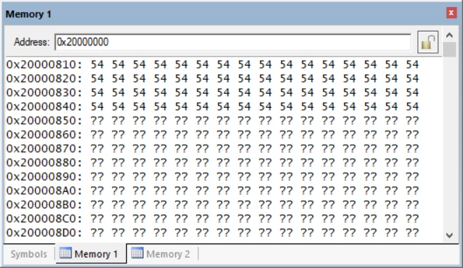

Keil shows

Is this a known Problem?
Is there a workaround?
Can you replace the faulty Nucleo?

I can readout the flash without an problem.
I can readout most part of the RAM.
But on some address I get this error (STM32CubeProgrammer) or '?' (Keil)
I think the chip has a bad RAM.
