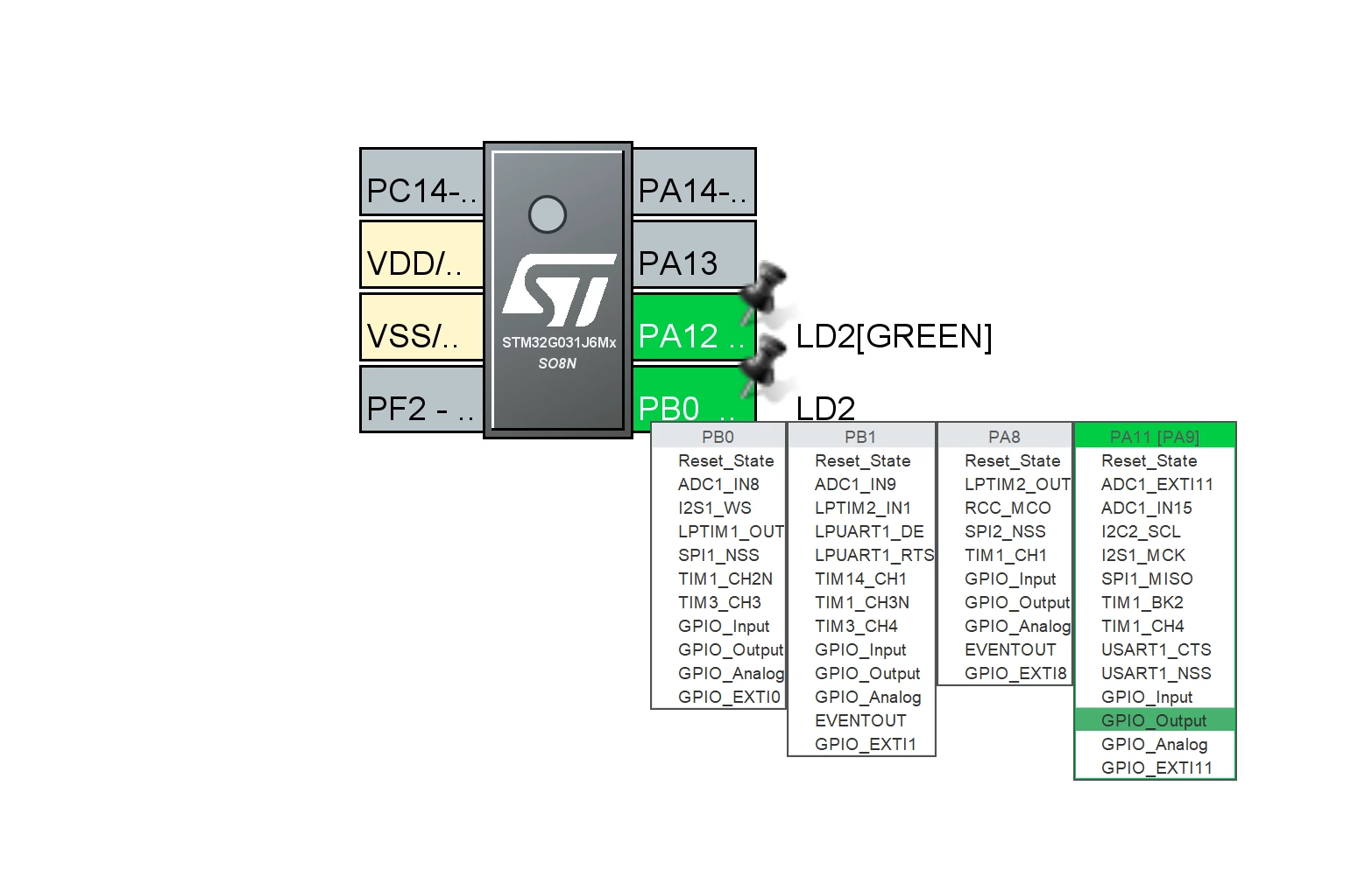

Hi, i just started with STM32G031J6 using STM32G0316-DISCO board.
Using CubeIDE i have configured my second LED LD1 on pin PA11
After generated the code by IDE, I added sections for flashing these LEDs. LD2 works perfectly, but there is  a problem with LD1 on the PA11 pin (I tried to change it to another possible one on this pin, but it's still the same) looks liek GPIO is not reconfigured to GPIO_Output.
Here is the generated code:

mƎALLEm
mƎALLEmBest answer
Jan 29, 2025 9:20 AM UTC
At this level, I suggest you to use STM32CubeMx configurator tool.
Attached a project where PA11 is toggling well along with with LD2 on STM32G0316-DISCO.
If you don't see PA11 toggling I'm pretty sure it's a hardware issue.
Hope that helps.

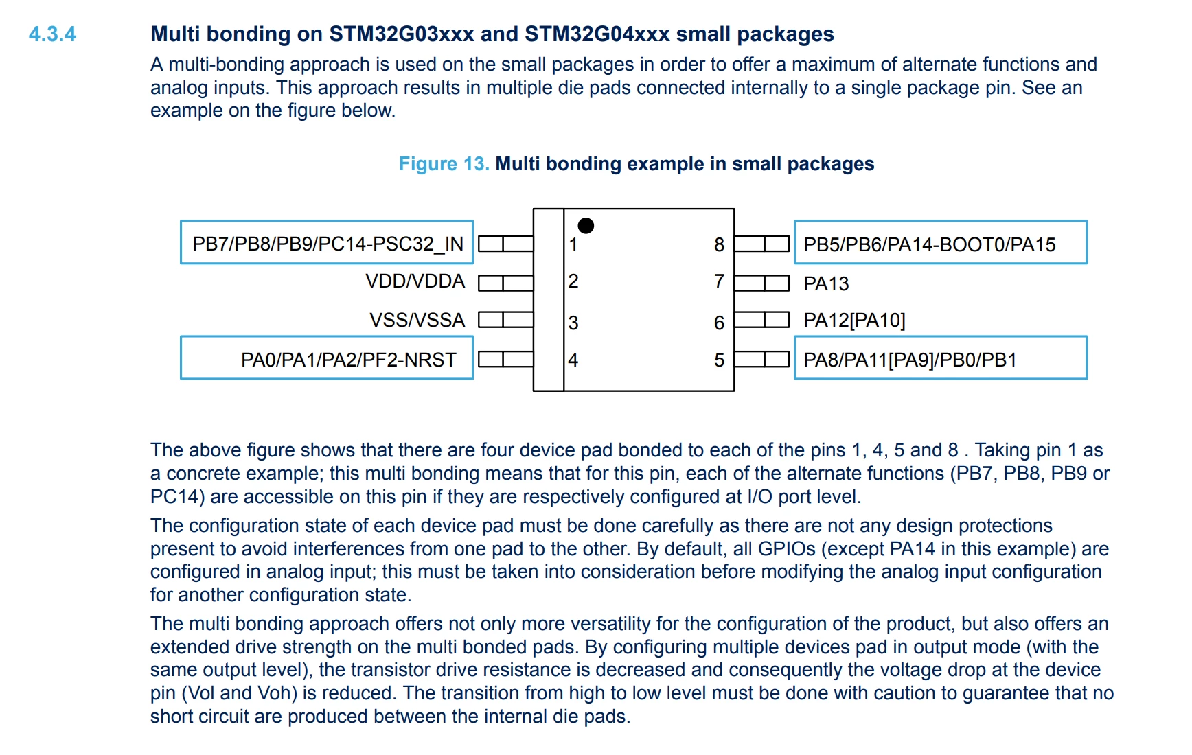

Mario3Author
Jan 28, 2025 9:50 PM UTC
I belive that my problem is connected with multi-bonding, but i do not know how to configure.

Mario3Author
Jan 29, 2025 9:36 AM UTC
Hi, whole project (with LD2 and my new led)  has been generated in STM32CubeMx,
LD2 is blinking correctly.
mƎALLEm
Jan 29, 2025 9:38 AM UTC
I'm not seeing a sign of that in the code you shared: no User Code Begin/End.
And what about PA11 with the project I shared with you?
Mario3Author
Jan 29, 2025 12:05 PM UTC
Problem solved !, Broken microcontroller, another one working as expected !
Thank You All for the help !
