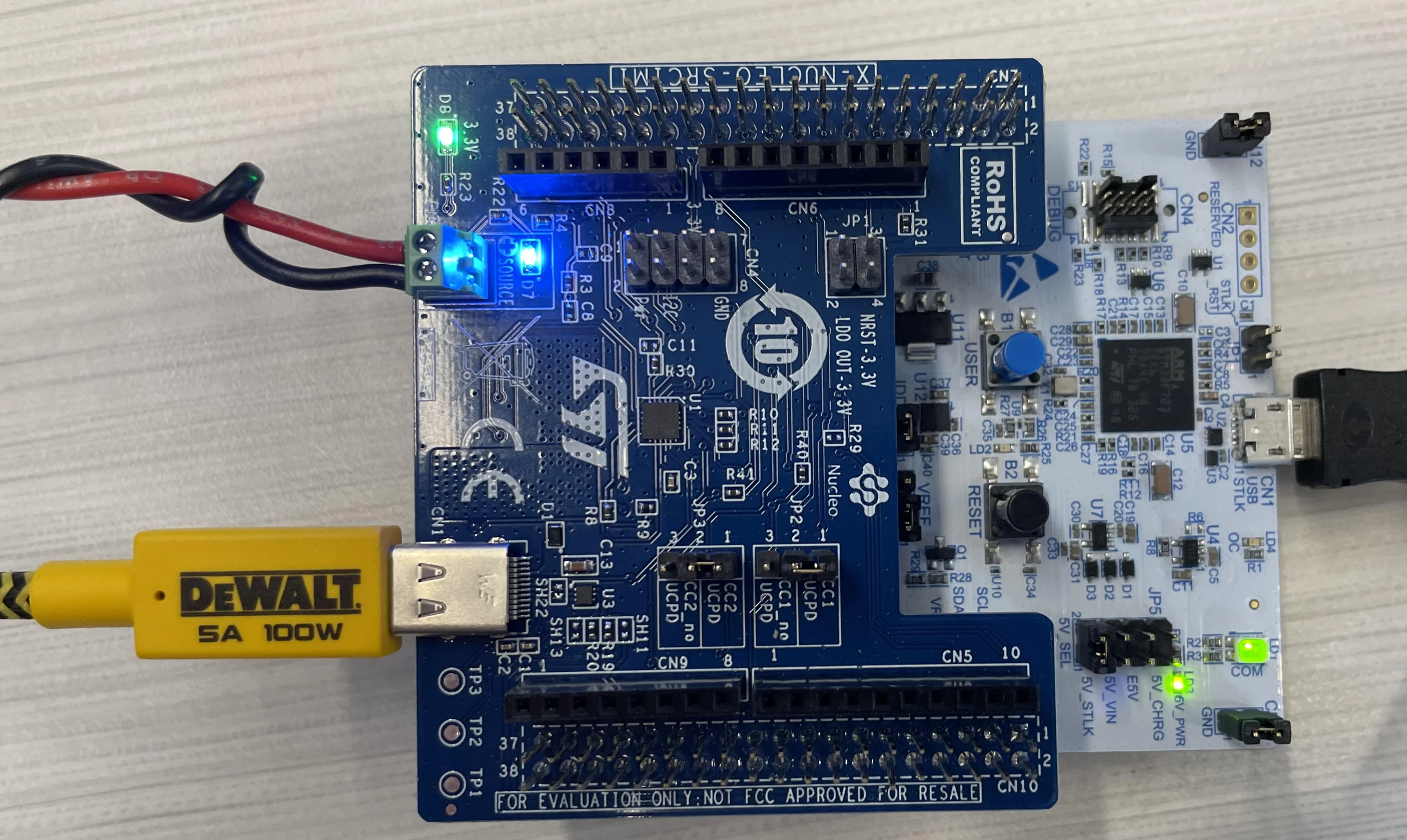

STM32G0 + X-NUCLEO-SRC1M1 Not Detecting Sink Negotiation Message

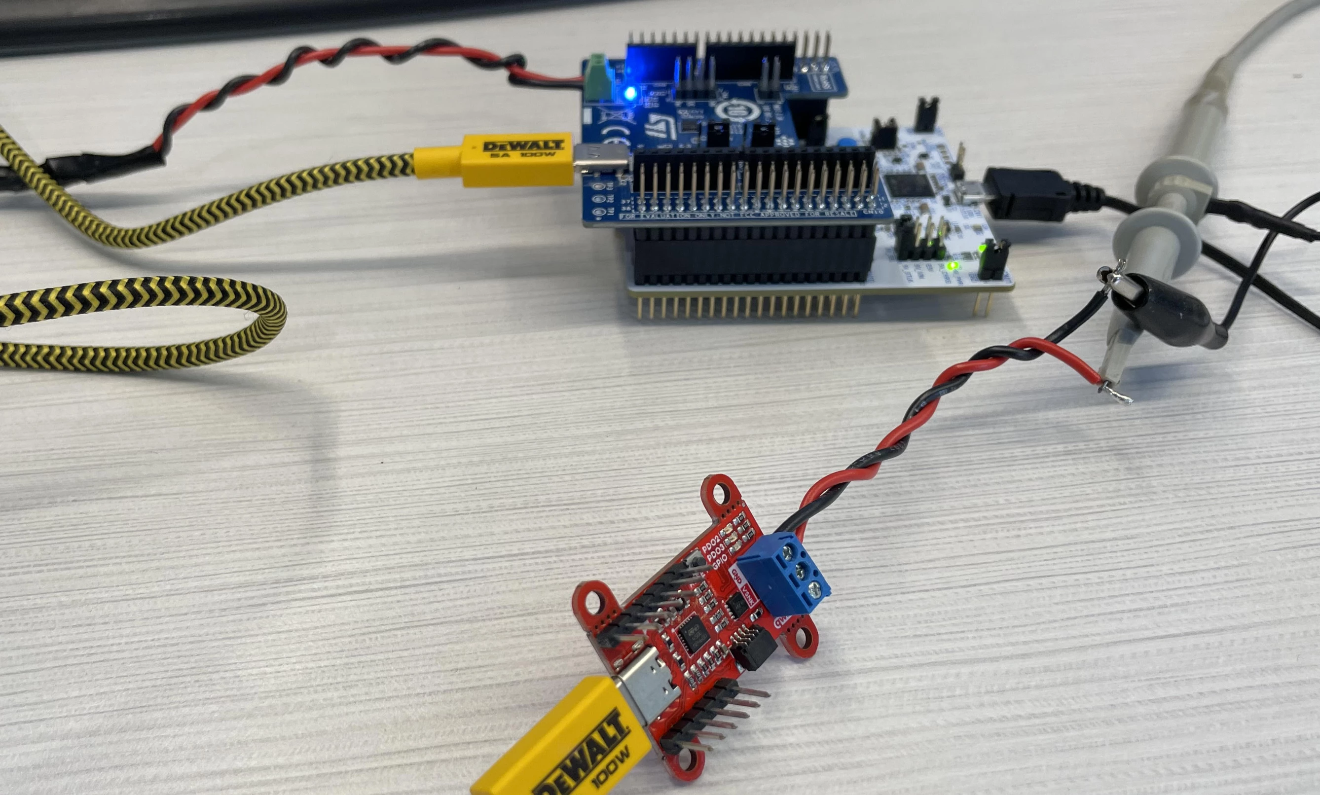

I'm a researcher at MIT and I'm pretty new to the ST world, I'm working on a USB power delivery application for a robotics project where I would like to use an STM32 MCU + an X-NUCLEO-SRC1M1 to deliver 20V over USB-C (as well as data over D+ and D-) to a Sparkfun STUSB4500 USB-C Power Delivery Board (https://learn.sparkfun.com/tutorials/power-delivery-board---usb-c-qwiic-hookup-guide).
Issue:

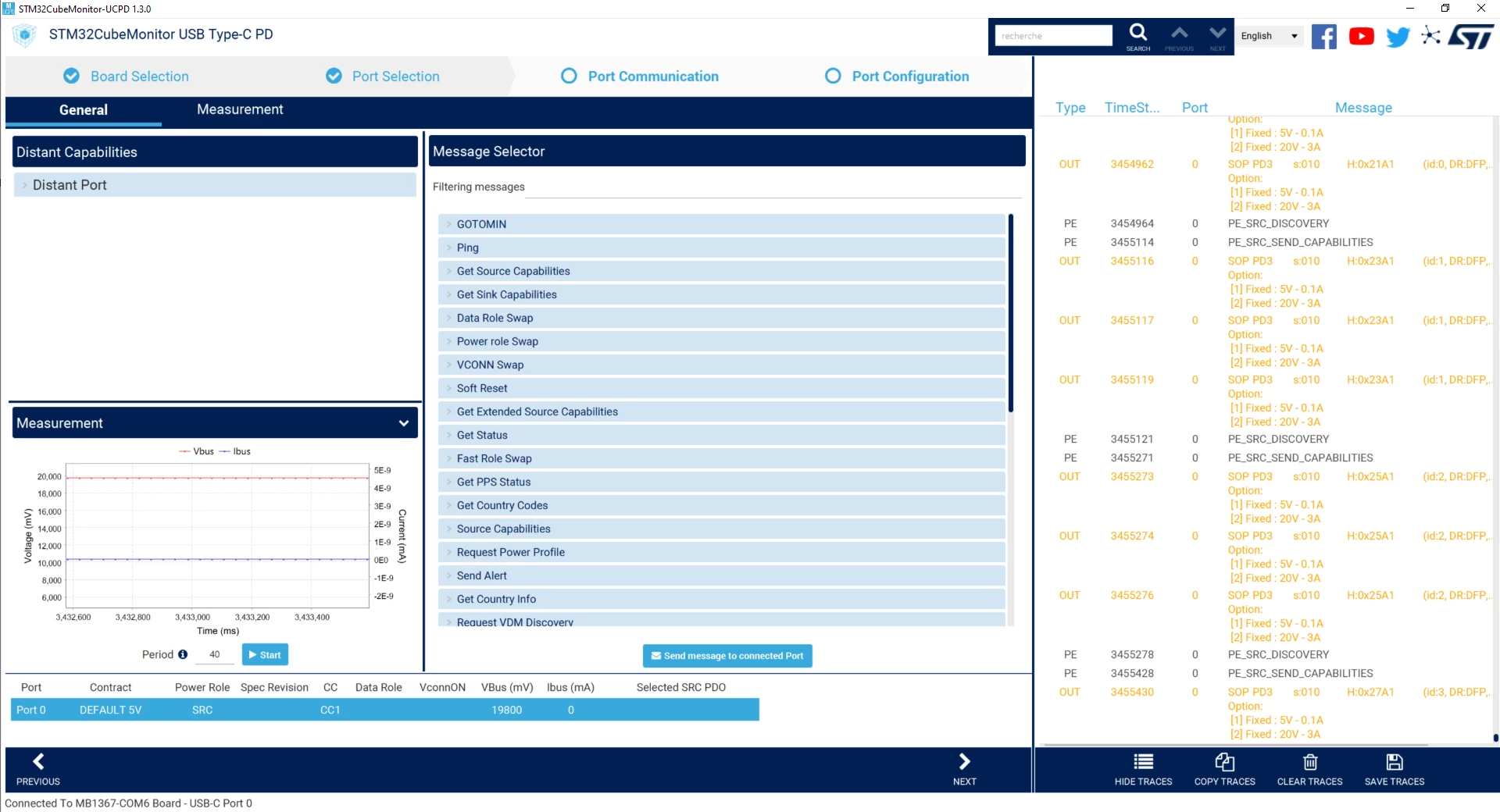

After plugging in my STUSB4500 sink board, there is no negotiation completed. The source is able to send out it's power delivery capabilities, but no messages are received from the sink in the traces of STM32CubeMonitor.
OUT	471419	0	SOP	 PD3	s:010	 H:0x27A1 	(id:3, DR:DFP, PR:SRC) 	SRC_CAPABILITIES	DATA: 0A9001002C410600
Option:
 [1] Fixed : 5V - 0.1A
 [2] Fixed : 20V - 3A
	11880
OUT	471421	0	SOP	 PD3	s:010	 H:0x27A1 	(id:3, DR:DFP, PR:SRC) 	SRC_CAPABILITIES	DATA: 0A9001002C410600
Option:
	11881
PE	471423	0	PE_SRC_DISCOVERY	11882
PE	471573	0	PE_SRC_SEND_CAPABILITIES	11883
OUT	471575	0	SOP	 PD3	s:010	 H:0x29A1 	(id:4, DR:DFP, PR:SRC) 	SRC_CAPABILITIES	DATA: 0A9001002C410600
Option:
	11884
OUT	471576	0	SOP	 PD3	s:010	 H:0x29A1 	(id:4, DR:DFP, PR:SRC) 	SRC_CAPABILITIES	DATA: 0A9001002C410600
Option:
	11885
OUT	471578	0	SOP	 PD3	s:010	 H:0x29A1 	(id:4, DR:DFP, PR:SRC) 	SRC_CAPABILITIES	DATA: 0A9001002C410600
Option:
	11886
PE	471580	0	PE_SRC_DISCOVERY	11887
PE	471730	0	PE_SRC_SEND_CAPABILITIES	11888
OUT	471732	0	SOP	 PD3	s:010	 H:0x2BA1 	(id:5, DR:DFP, PR:SRC) 	SRC_CAPABILITIES	DATA: 0A9001002C410600
Option:
	11889
OUT	471733	0	SOP	 PD3	s:010	 H:0x2BA1 	(id:5, DR:DFP, PR:SRC) 	SRC_CAPABILITIES	DATA: 0A9001002C410600
Option:
	11890
OUT	471735	0	SOP	 PD3	s:010	 H:0x2BA1 	(id:5, DR:DFP, PR:SRC) 	SRC_CAPABILITIES	DATA: 0A9001002C410600
Option:
	11891
PE	471737	0	PE_SRC_DISCOVERY	11892
PE	471887	0	PE_SRC_SEND_CAPABILITIES	11893
OUT	471889	0	SOP	 PD3	s:010	 H:0x2DA1 	(id:6, DR:DFP, PR:SRC) 	SRC_CAPABILITIES	DATA: 0A9001002C410600
Option:
	11894

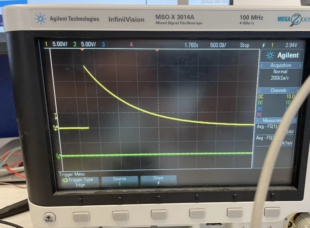

On the oscilloscope, the sink board gets a 20V spike that then decreases since the power delivery negotiation never finishes.
I do not think  this is a sink issue as connecting the sink to a USB-C Dewalt charging power brick that delivers 65W can provide a sustained 20V after 5V. The negotiation seems to complete itself.
Hardware Setup:
I've connected a 20V supply to CN3 of the SRC1M1 board and validated 20V is going into the terminal. A USB-C power cable is connecting CN1 to the Sparkfun power delivery sink board. A Micro-USB cable connects the STM32 NUCLEO-G0B1RE MCU to my computer to view debug logs. I connected the oscilloscope probes to the output power terminals of the sink board.
Software Setup:

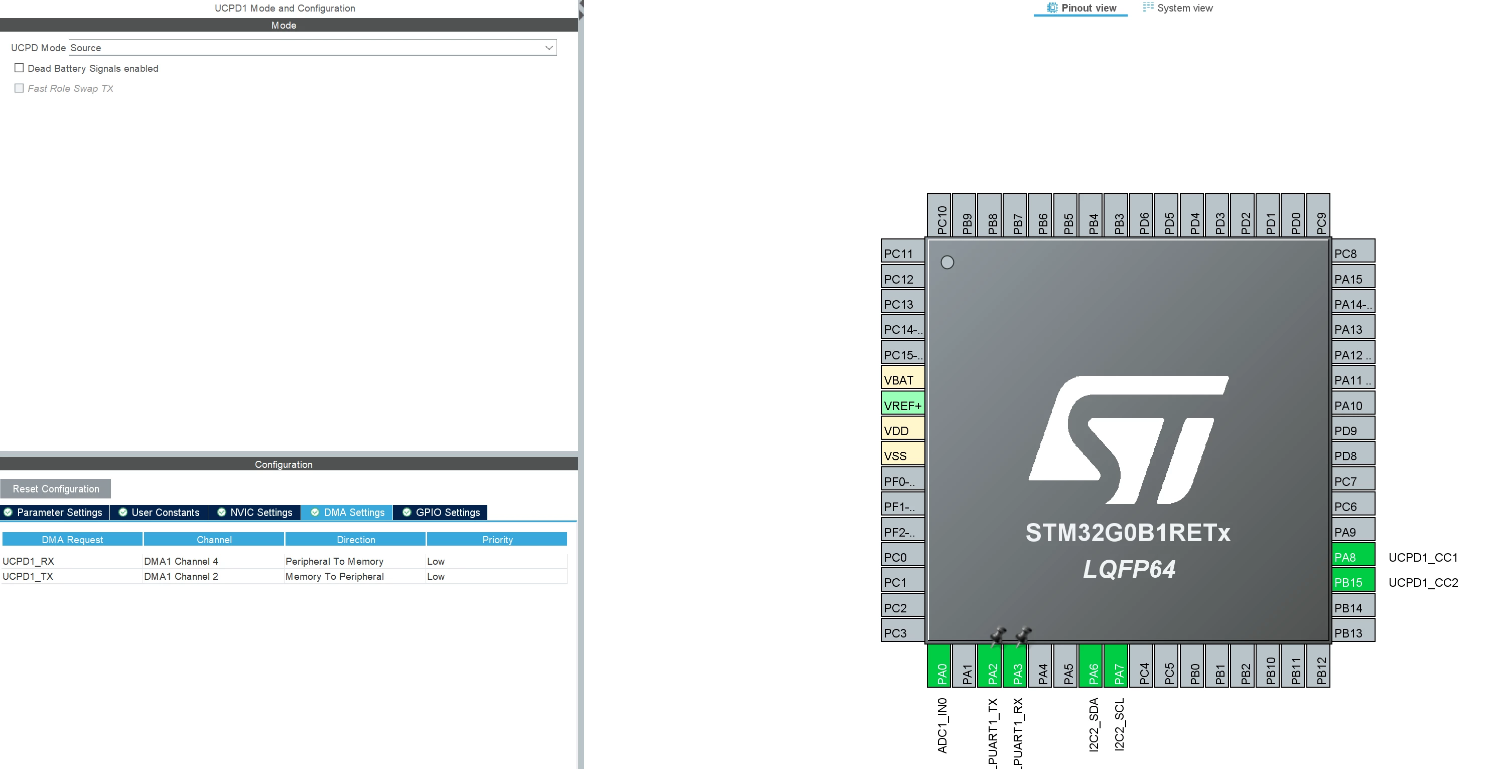

I've followed the USB PD wiki closely (https://wiki.st.com/stm32mcu/wiki/STM32StepByStep:Getting_started_with_USB-Power_Delivery_Source) and made an STM32 project using the STM Cube IDE (https://github.com/michaellu2019/STM32G0_USBPD_Source) for the Nucleo G0B1RE board. I've downloaded the STM32 Cube Monitor to see debug logs. I have also tested uploading a completed binary (https://github.com/STMicroelectronics/x-cube-tcpp/blob/main/Projects/NUCLEO-G474RE/Applications/USB_PD/SRC1M1_Source/Binary/G4_SRC1M1_Source.bin) to my Nucleo-G474RE to cross check my software, but run into the same issue of no sink communication. The Sparkfun STUSB4500 board has been configured to receive 20V 3000mA, which is one of the listed PD options in the SRC1M1.
Please let me know if there is something I'm missing in my project setup, whether that be following the wiki to set up the G0 or if downloading the G4 binary is not sufficient to set up a project. Happy to set up a call to expedite the discussion.
Thanks,
Michael

I think your setup on SRC side would need to be able to provide 5V first, then after negotiation something else (20V for example). If you look at oscilloscope plot when facing USB-C Dewalt charging power brick, you see that after PD port is connected from SRC side, 5V is provided as VBUS.
At this stage, SRC capa are sent, and SNK side could request something else than 5V.
When negotiated, then SRC could provide 20V, not from start.
I think that what is happening in your case, is that when SNK Rd are detected from SRC side, VBUS is provided by configuring TCCP02 Provider Gate (on SRC1M1 shield). As 20V are supplied on CN3, 20V are provided on VBUS. I assume that SNK side enters in security mode, as only expecting 5V at this stage.

Thx for the response @Guenael Cadier, if I understand correctly your concern is that VBus is at 20V as CN3 gets 20V, but the SNK board requests 5V first before 20V and thus enters a state where it won't negotiate power as the SRC voltage is initially too high?
So would the fix entail adding another PD option (5V, 3A which does exist already based on the traces in monitor?) or changing the voltage provided to CN3 and making it some dynamic source 5V at first then 20V?

USB standard requests to always start with 5V. Any PD product needs to first follow TypeC requirement which is VBUS@5V.
STUSB4500 takes care about Vbus voltage during the TypeC phase. If Vbus is above 5V limits, it detects an error and goes into ErrorRecovery state to force a detach which the 'failing source'.
To get only 20V for your application, you can set STUSB4500 'ABOVE5V bit' and setup only 2 PDOs (5V which is mandatory and 20V), in the NVM. stusb4500 will then negotiate 20V when it is available in source_capabilities and close the power path only after 20V negotiation.
But source needs always to start with 5V in TypeC, provides its source_capabilities and upon request, provide 20V.

Thank you for the clarification @NBALL and @Guenael Cadier. Are either of you able to provide any concrete steps to configure the SRC1M1 board to complete this 5V to 20V transition, as it seems that following example wikis and preconfigured binaries does not achieve this? I was under the impression that all this would work out of the box.
I believe the STUSB4500 is already configured to accept this (given the oscilloscope capture with a USB-C PD brick), so I suspect it's a matter of the "source needs always to start with 5V in TypeC" as you said. Are there any examples online where a the SRC1M1 is configured to provide more than 5V?

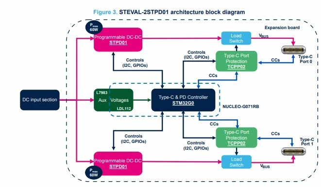

I would suggest to use STEVAL-2STPD01 which embeds DCDC converter and is able to change DCDC voltage based on stusb4500 request. It is also stm32G0+TCPP02 (like your today setup) but also STPD01 DCDC.
With board you are currently using, you would have to use GPIO to change voltage regulation of your power source, based on sink (stusb4500) request.

STEVAL-2TPD01, USB Type-C Power Delivery dual port adapter based on programmable buck converter (60W for each port), documentation is available on web on documentation tab. User manual details technical behavior while the Quick Start Guide provides a kit overview + basic setup & programming.
Below, documentation extract shows architecture block diagram with main part numbers to performs key functions (DC/DCs, MCU, HV interfaces and protections) and links between them.
SW and HW resources are also available.

Below board possibilities:
* NUCLEO + X-NUCLEO : MCU with PD-controller + HV interface + protection for a single type-C SOURCE port. A PD compatible source driven by MCU resources (I2C or GPIO) is needed. The solution is USB-PD 20V-5A compliant. STM32 data can be activated.
* STEVAL-2STPD01 : MCU + PD-controller + DC/DC + protection for dual dual type-C adapter. A 24V (60W for one port or 120W  for two ports) DC source needs to be connected. Data are not available as this reference design is an adapter.
To match to your case, it seems that a specific HW development is required. DIY with flying wires is a good way to secure HW development. I would suggest : STEVAL-2TPD01 (single port used) plug on top of NUCLEO-G0B1RE because STM32G0B1RE  embbeds USB-HOST interface + power delivery controller. Then pick USB D+/- directly from the type-C connector (R508 footprint) with flying wire to the MOSPHO connectors to be connected to the STM32.
It is not granted at all but it is one proposal to perform a POC (prof of concept) before moving to the final board. You need to check my assumption on NUCLEO + STEVAL pairing. To conclude, it is a low cost suggestion compared to a full HW project to develop your SW solution.

Based on that, you can connect your own favorite power source (DCDC/LDO/...) to SRC connector and only use 1 GPIO that you set in your SW to force the voltage transition: this GPIO can be used as enabling 20V and disabling 5V which is all what you need.
What's important is to transition with proper timings and to always start with 5V.
Best regards

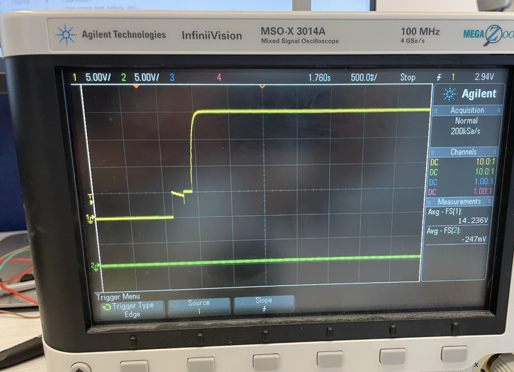

Thank you, I apologize for the confusion @NBALL. I have been able to source 5V from the SRC1M1 when configuring the sink board to request 5V and when applying 5V to the SRC1M1 through CN3. Let's continue this discussion only about the SRC1M1 board.
  1. Regarding using a GPIO pin to "force the voltage transition," are you saying use a GPIO pin to switch the voltage level going into CN3, i.e. using a transistor/relay to literally change the voltage going into my source board? If this is what you're suggesting, then I am confused how much the source board can actually benefit me at all besides having a USB-C cable. I was under the impression the SRC1M1 handles this switching automatically: I can always provide 20V to the board, and when I plug in different sink devices that require either 5V, 15V, or 20V, etc. the SRC board automatically sends that voltage level (with the appropriate voltage transitions you are mentioning).
  2. So I am checking the usbpd_dpm_user.c files and the usbpd_pwr_if.c files and the only method that seems related is USBPD_PWR_IF_SearchRequestedPDO() in usbpd_pwr_if.c. Are you saying that I would have to edit this method? Could you be more specific about what extra code I would have to add to what method to change the supply voltage from 5V to 20V when the sink requests it?
