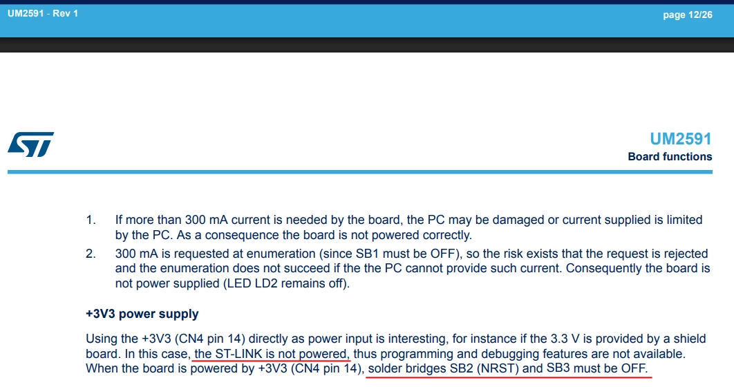

https://community.st.com/t5/stm32-mcus-boards-and-hardware/external-powering-of-nucleo-l031k6-hsi-able-to-run/m-p/663084/highlight/true#M18423
You should break SB2 to disconnect the Reset connection to the ST-Link;
Possibly also SB3 - to disconnect the VCP:

Bridging D5 does work by powering the ST Link subsection and subsequent release of the reset line. This also feeds the linear regulator U8 backwards, but I think it can take that.
