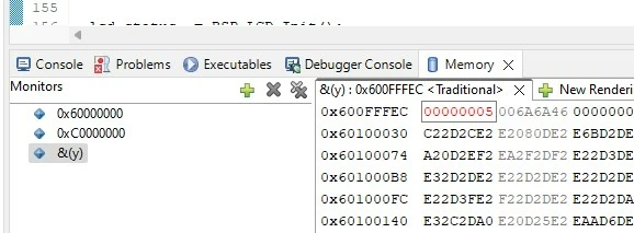

Is SDRAM working at all?
SLimi.1
SLimi.1Author
September 14, 2023
@waclawek.jan
It appears to be. As a test, an integer variable is created and incremented in the code. In the memory view, I can see the integer value changing on the remapped SDRAM starting at 0x6000 0000. It is the timer tick that doesn't work. Is there something that has to be remapped for the timer interrupts?
