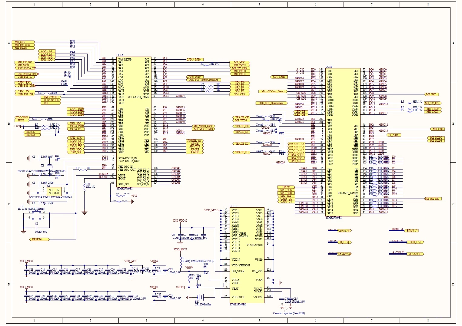

I have attached the schematic for MCU. I am using external stable power supply for test purpose so I have not included the power section.
September 4, 2021
VDD12DSI connected to VDD_MCU doesn't look right.

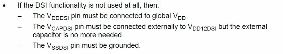

According to the datasheet page 29, if DSI is not used, then VDD12DSI must be connected to VDD:
TDKBest answer
September 4, 2021
No, it says VDDDSI must be connected to VDD.
It says VDD12DSI must be connected to VCAPDSI.
VDDDSI (pin 118) and VDD12DSI (pin 125) are different pins.
