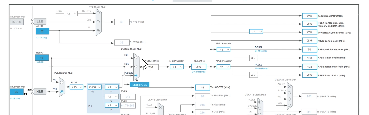

i have enabled the SWO from the debugger configuration and the clock is exactly as in the ioc file 216Mhz
When opening the debugger i select port 0 in the SWV console. The system has by itself a prescaller to 108 which i can not edit and the SWO clock is 2000.

Currently the clocks are set like in the screen from Touchgfx. What do you propose to change?
