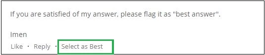

I didn't find a flag with a 'best anwer' caption. So i click on the thumb. You should be proud : it is the first time i do it ;)

You will find the "Select as Best" flag below in my previous answer.

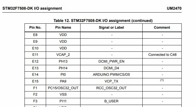

I wonder why it is so difficult to find simple information in the DK documentation !
I would like to know how can I find on which pin is connected the user button ! Where must I look for ?
I tried to find the declaration of 'gpio_pin_1' with no success (I found it in an example).
Jean
Nov 20, 2020 9:49 AM UTC
Hi @MJean.3​ ,
The specific assignments for each pin are detailed in the device datasheet: STM32F750x8 Datasheet , in the Table 10. STM32F750x8 pin and ball definition.
The user button (B_USER) is connected to the PI11.

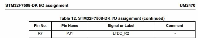

0693W000005C5AAQA0.jpg>> I tried to find the declaration of 'gpio_pin_1' with no success (I found it in an example).
Do you mean PJ1 pin ?
