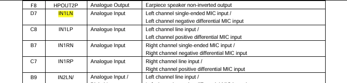

So, ...
no signal -31dB
1.3Vrms  ->  -2dB
0.4Vrms -> -2dB
0.144Vrms -> -2dB
5mVrms -> -5dB
aciuf
aciufAuthor
August 3, 2024
The problem could be on the evaluation board because the line input is a mic input, so probably I saturate the input with my signal.
I will check tomorrow if this is true.

I have modified the source WM8994.c to exclude the +30dB gain on input
Now the my signal does not saturate the input but still strange output:
input
   0dB  1.349Vrms   ->   on lcd read  -1dB
 -3dB   0.97Vrms    ->   on lcd read   -7dB
-10dB   0.43Vrms    ->   on lcd read -35dB
disconnected signal on lcd read -96dB
Do I have to apply a conversion to the smr_dynamic_param value ? because in the example there is a * 0.25.
 case INPUT_DEVICE_INPUT_LINE_1 :
 	BSP_LCD_DisplayStringAt(10, 80, (uint8_t *)"--INPUT_DEVICE_INPUT_LINE_1--", 0);
 /* IN1LN_TO_IN1L, IN1LP_TO_VMID, IN1RN_TO_IN1R, IN1RP_TO_VMID */
 // 0x0011 = 00010001
 // | +- IN1RN_TO_IN1R
 // +-- IN1LN_TO_IN1L
 counter += CODEC_IO_Write(DeviceAddr, 0x28, 0x0011);
 /* Disable mute on IN1L_TO_MIXINL and +30dB on IN1L PGA output */
 //counter += CODEC_IO_Write(DeviceAddr, 0x29, 0x0035);
 // 0x0035 = 00110101
 // +++ 0dB
 // + +30dB
 // + unmute IN1L
 // 0x0025 = 001000101
 // +++ 0dB
 // +-- 0dB
 // +--- unmute IN1L
 counter += CODEC_IO_Write(DeviceAddr, 0x29, 0x0025);
 /* Disable mute on IN1R_TO_MIXINL, Gain = +30dB */
 counter += CODEC_IO_Write(DeviceAddr, 0x2A, 0x0025);
