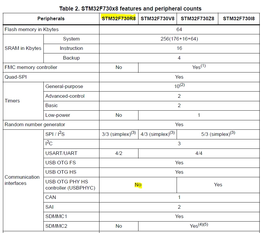

STM32F730R8T6 USB HS init fail
I've a stm32f730r8t6 core board, I need to use stm32 as USB HS device, looks like STM32CubeMX generate the code have bugs.
If using USB_FS is working fine but USB_HS is not.
I've traced the code failed at USB_CoreReset.

Sorry, I look datasheed again, R serial dones't support internal HS phy.(I didn't connect any external phy.)

Thank you for your question.
It is difficult to answer, without seeing the .ioc file. or the source code, but
one thing I can see is that USB HS pins are not connected to any USB connector.
They are normally PB14 and PB15 for the USB HS block.
