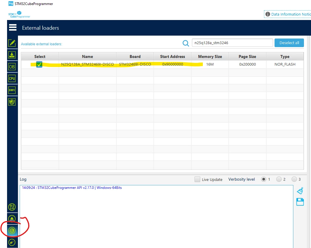

You'll need to select an External Loader associated with the STM32F469I-DISCO to write content at 0x90000000 into the Micron N25Q128 QSPI NOR FLASH
STM32 Cube Programmer natively only supports writes into the Internal FLASH of the STM32F4

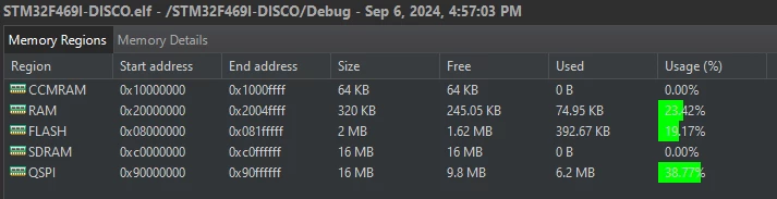

This is happening with a complex application designed by TouchGFX and STM32CubeIDE. We build the GUI with TouchGFX and then we edit the low level code with STM32CubeIDE.

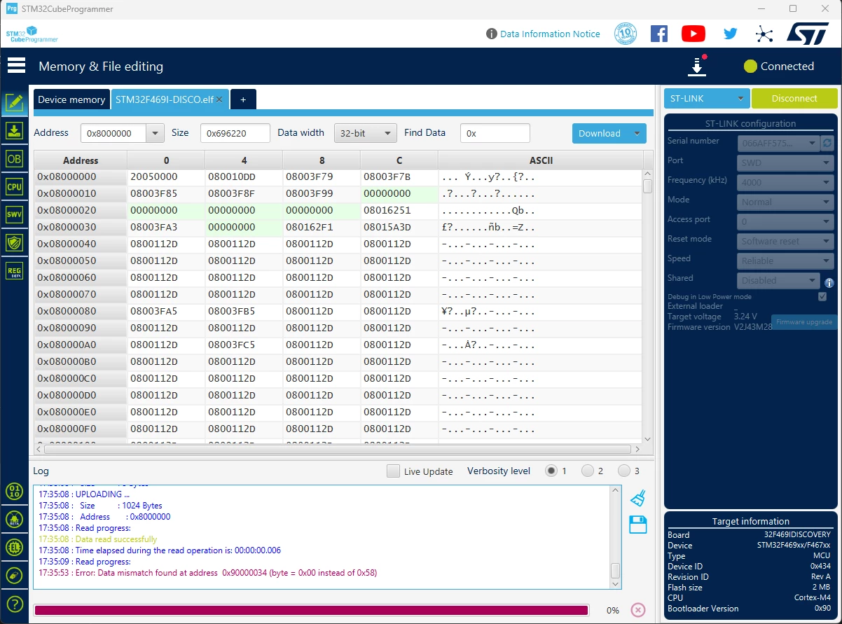

I've never done a CRC on an image or what's on device memory, do you have a perferred method that you use for situations like this? I see that there is a Verify option in the programmer. I've never used it before today. I think its comparing what is in memory vs what is in the device according to what is in documentation (STM32CubeProgrammer software description - User manual). I did a fresh download to the device and then verified. It failed. I get the feeling that I will never get the verify to 100% check out.
Looks like I am using internal FLASH and External QSPI:

Did you setup the STM32Cube Programmer for External Loader and select the correct flash memory?
