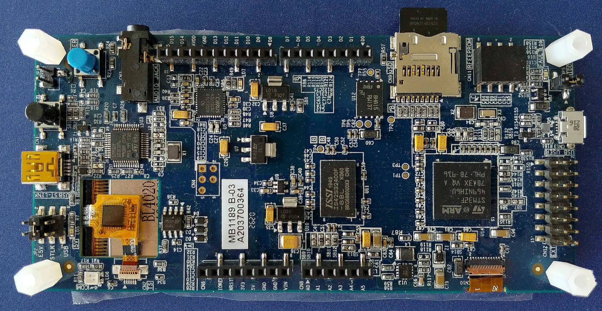

I own a STM32F469-Discovery Board bought in 2021. There seem to be (at least) two revisions of that board, "B" & "C" and maybe "A".
Under "CAD Resources" are just schematics for Revision "B" and "C".
If I try to run the supplied example for that board, for example "LCD_DSI_VideoMode_SingleBuffer" I have to choose correct Revision in the code.
Revision "B" seems to work good, "A" not so perfect (flickering) and "C" totally scrambled display... So I assume that I have Revision "B" board.
But if I now look into the schematic of board revision "B" I see there is SDRAM "MICRON MT48LC4M32B2B5-6A" installed. But if I inspect my board there is clearly a "ISSI IS42S32400F" BGA chip installed. In the schematic of revision "C" instead is drawn the same "ISSI IS42S32400F".
Now I am confused.
Can you please enlighten me?
Mike_ST
Mike_STBest answer
June 16, 2021
So this is a revision B-03 PCB.
Assembled W37 2020.
Please use rev B schematic.
Probably the SDRAM reference has been swapped for availability reason.

Hello @PGroe.2​ ,
Thanks for pointing out this confusion with the STM32F469-DISCO revisions.
Can you please share the stickers pictures on the boards ?
In this way I can have the batch and revision, and I'll check it out and come back to you with an answer.

Sure:
Mike_ST
June 16, 2021
if possible, can you upload picture of other side as well ?
