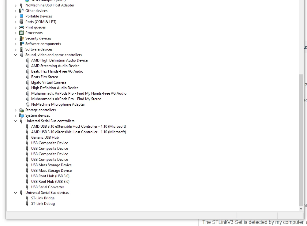

The STLinkV3-Set is detected by my computer, as seen in the following image.

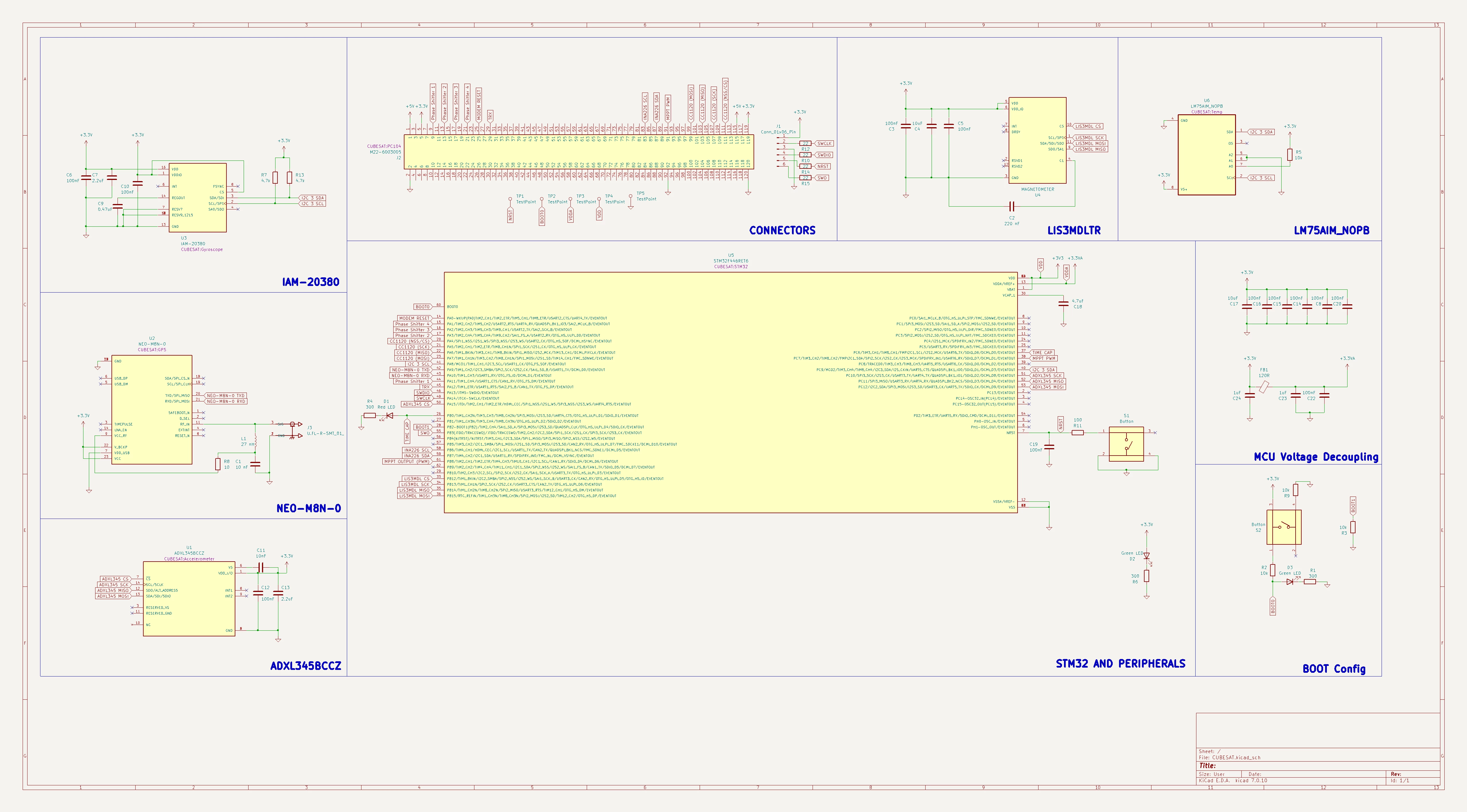

The full schematic is attached as a file to this post.

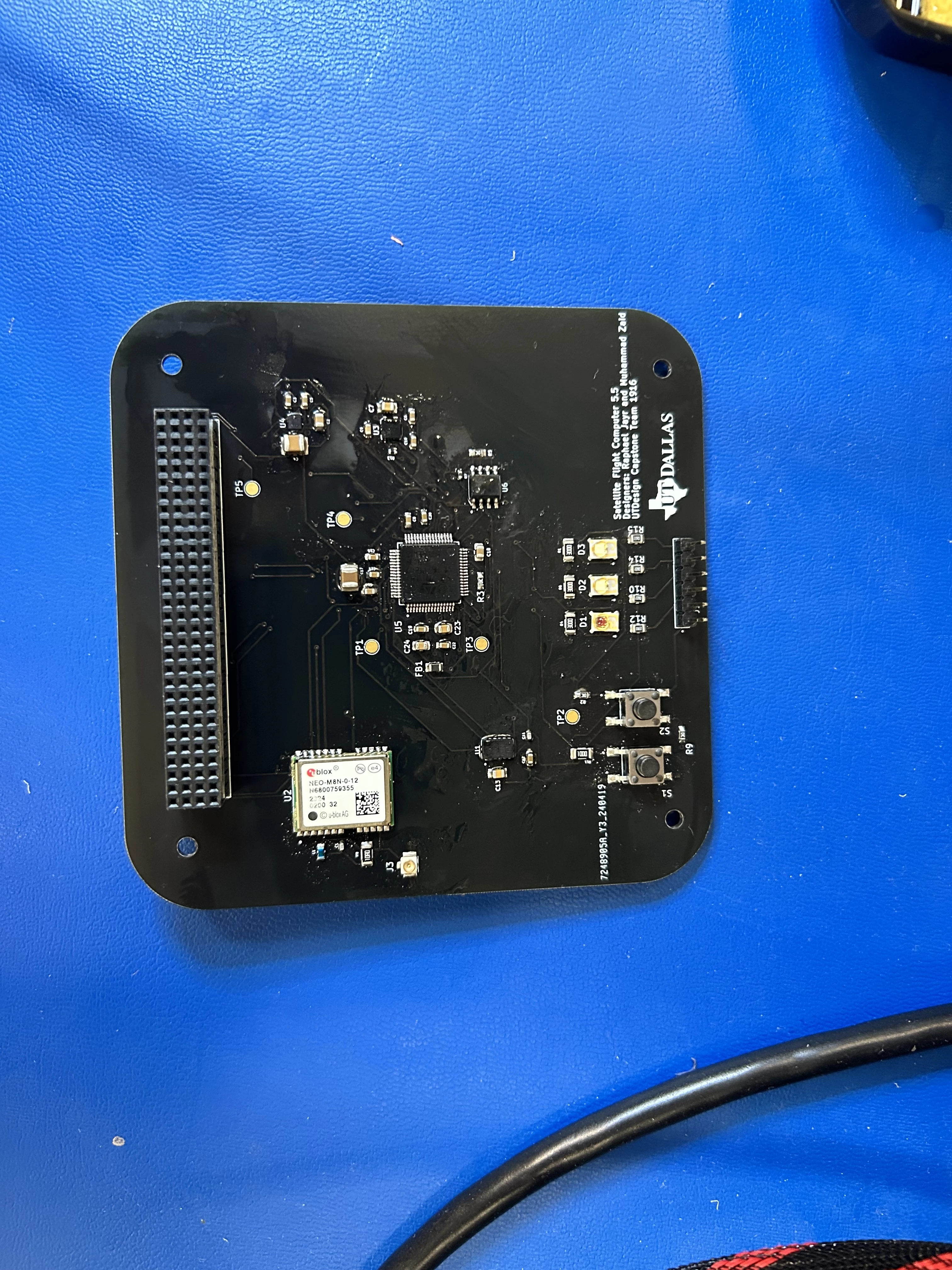

Same is true for the full definition image of the printed board.
Any suggestions or help would be greatly appreciated, I am basically at my wits end with this.
