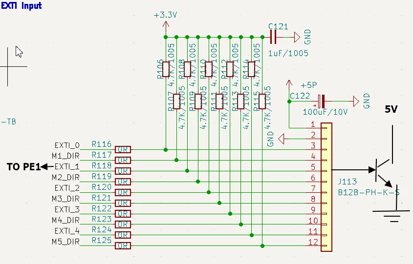

STM32F429ZITx resets whenever PE1 pin pulled to GND by a npn type sensor.
This is very weird problem as I have never experienced this kind of problem before.
The board is hooked up to several NPN type limit sensor and connected PE0, PE1 etc.
Every pins are defined as EXTI with Rising/Falling edge trigger and has been working good until I figured out that PE1 pulled by the limit sensor causes resetting the MCU.

Or maybe a hardware issue:
I suppose you have a pull-up to VCC at the npn collector.
If that pull-up is too low, like accidentally placed 10R instead of 10k, then VCC is shortened and will cause the MCU to reset.

The limit switch is working with 5V and PE1 is connected as below.
All other pins works just fine.
I don't know why this pin doesn't even trigger an ISR and simply reset the MCU as if it is like NRST pin.

  • Checked R109?
  • Have you connected a scope and checked what the hardware is doing?
  • And you're sure that the npn is connected that way, with EXTI_1 connected to the npn's base? I would expect the level of EXTI_1 to be permanently at about 0.7V (base-emitter diode) or so...

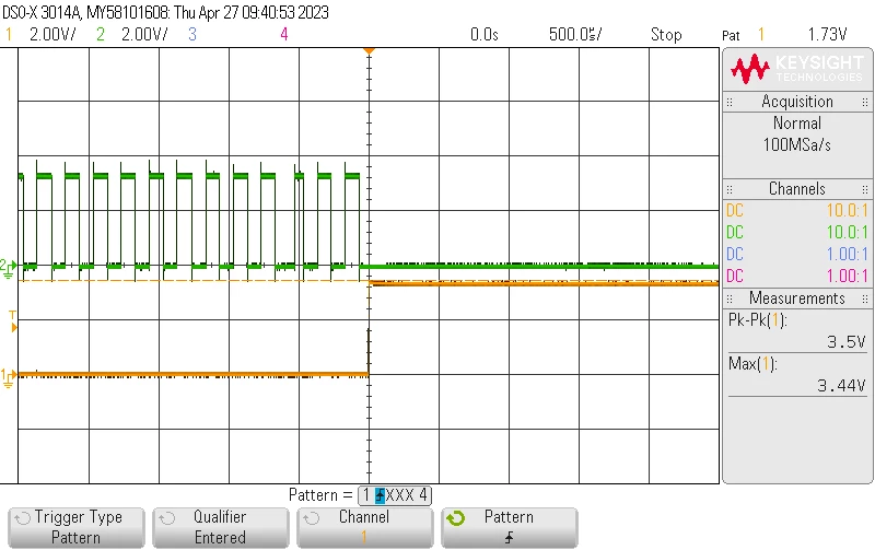

Please take a look at below output.
CH1(Yello) is hooked up to the PE1 pin
CH2 (Green) is hooked up to a gpio toggle from the program.
As soon as the PE1 pin goes high(the limit sensor is cleared), the toggle output stops.
After a one or two seconds the program restarts again.

So it's PE1 going HIGH that seems to be the trouble, not LOW.
> Connect PDR_ON to VDD.
Have you done what Jan said?
Have you checked the other things we mentioned?
If yes and the problem still persists, it's time to post some source code concerning that GPIO init, interrupt init, interrupt handler, etcpp...

The reason I said the problem is at PE1 LOW because it was normally HIGH and program shuts down when PE1 becomes HIGH from LOW state.
I will try to Jan's idea but I need to modify the PCB.
