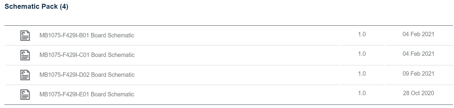

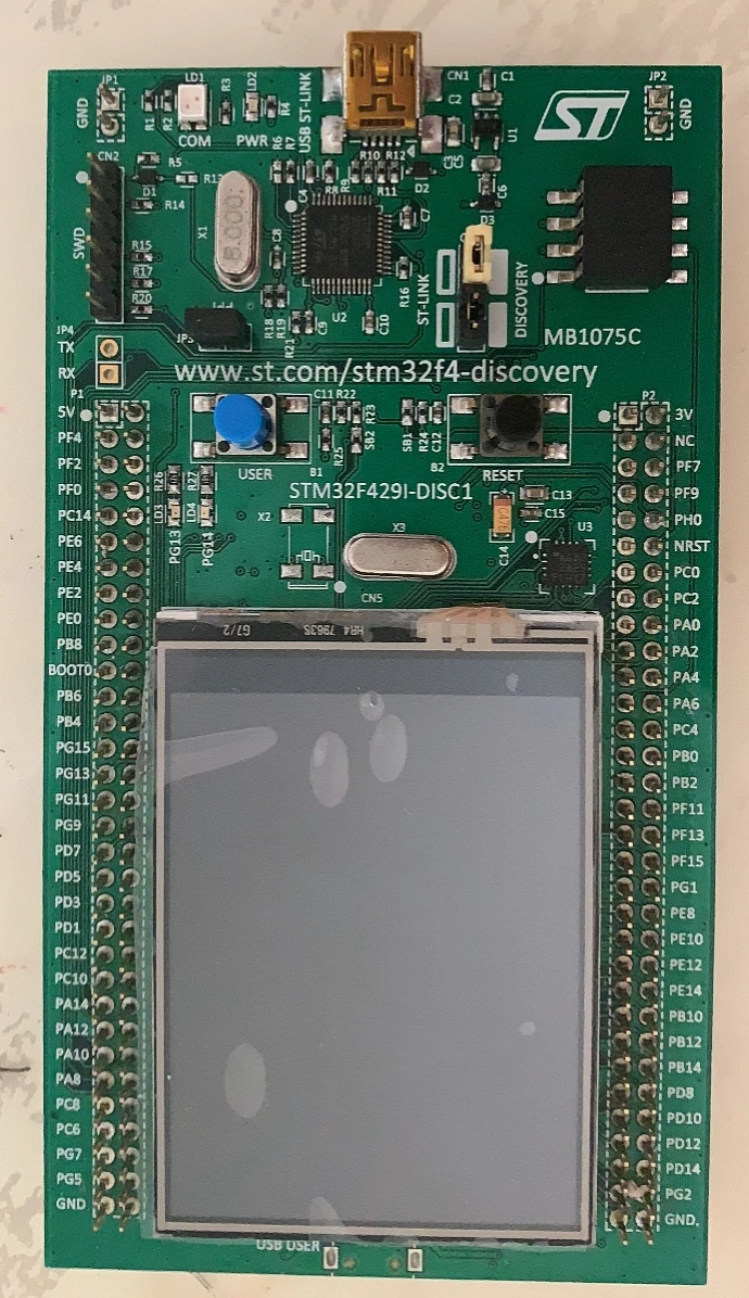

I bought a second-hand stm32f429 discovery board, here is its image.
0693W00000QLk4eQAD.jpgI found 4 schematics on ST website (MB1075b~MB1075e), but I can't confirm which one corresponding to my discovery board. 0693W00000QLkF8QAL.jpgAccroding to the information shown on board , my board is DISC1. But on ST website DISC1's PCB is blue while mine is green, I'm not sure about my board's version.

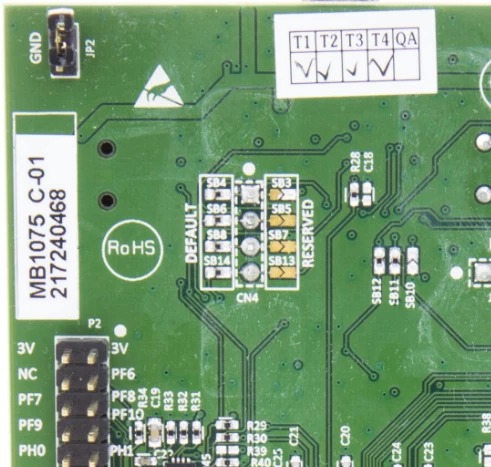

There should also be a sticker on the back of the board:

The board is labled MB1075C below the extension connector. So MB1075-F427-C01 schematic should apply.
