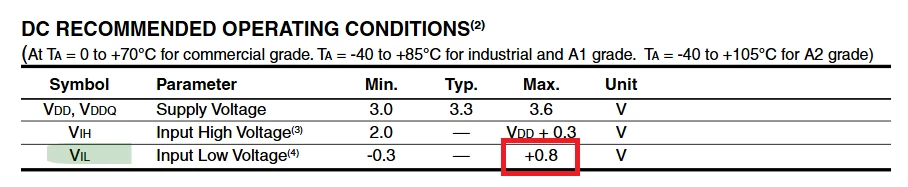

8. Reconfigured that exact same physical processor pin to just be a simple on/off output (nothing to do with memory at all) and measured it with a multimeter. It does switch on and off, but instead of cleanly reaching full voltage (around 3.3V) and full zero (0V), it only reaches about 2.9V and 0.8V - a weaker signal than it should be.
My question: Since changing every single software/timing setting I can find made absolutely no difference, and the problem is stuck to one exact physical pin on the chip (the one connected to this particular bit of the memory chip), does this sound like a physical/hardware fault on this specific board (like a bad solder connection) rather than something fixable in software? Or is there some other software explanation for one single, fixed bit always being wrong that I might be missing - since this doesn't match any of the timing-related bugs ST has documented?

Hello ​@gp2026 and welcome to the ST community,
Please try the example provided in the STM32F4 Cube HAL to validate the hardware:
https://github.com/STMicroelectronics/STM32CubeF4/tree/master/Projects/STM32F429I-Discovery/Examples/FMC/FMC_SDRAM
If the example isn’t working, you have an issue with the board and based on your statement, most probably the pin is broken:
The SDRAM datasheet for the IS42S16400J specifies a maximum VIL of 0.8 V, while you are measuring 0.8 V, and possibly more if measurement errors are taken into account:
