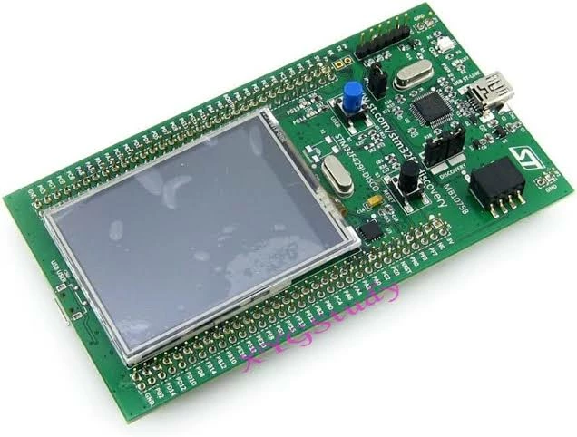

Internally, there are protection diodes which protect over-voltage conditions. These are present for emergency situations to avoid damaging the chip. However, they are not meant to be used all the time. Eventually, they will degrade and wear out due to accumulation of thermal and electrical stress.
If you want to learn more, you can look up accumulation of damage due to ESD events to understand what is happening at the silicon level. Just because it works once doesn't mean it will always work.

@harry123 wrote:
Will my gpio pin gets effected if I give a voltage of 4v
What GPIO are you using? Is it 5V tolerant?
@harry123 wrote:
my board Is not working it is getting heated once i connect the supply through usb.
More details on that.
What else do you have connected?

1) I'm using Stm32f429 disc 1 board
2)I wanted to measure a signal using internal adc with reference voltage of 3.3v . The gpios I'm using are pa2,pa3,pa6 all are of different voltages of 2.7v, 2v and 4v.
3) Suddenly the board stopped working and it's showing st link not detected when I start debugging.

Pins are not 5V tolerant when they're in analog mode (e.g. being used by the ADC). Putting them above VREF can damage the board.
If you remove the voltage and the board works okay, good, but something may have been damaged.
