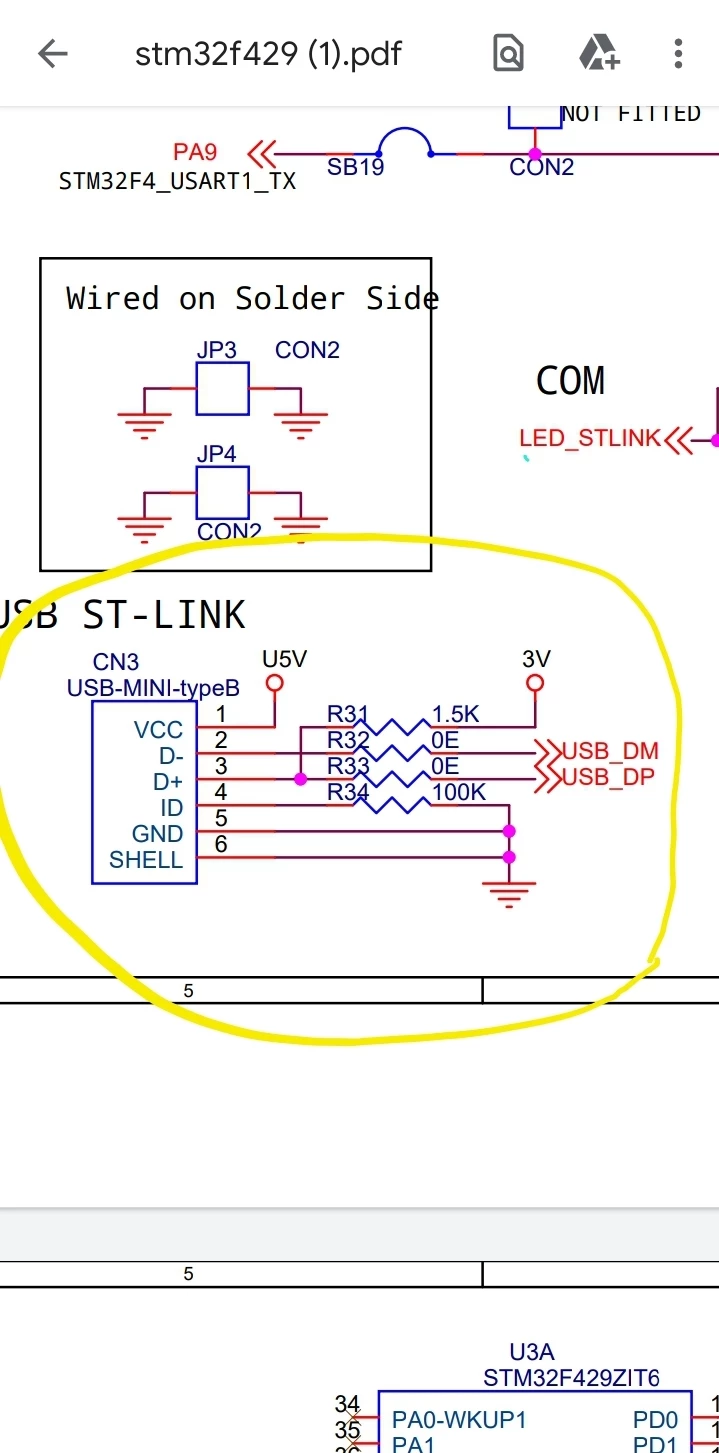

  • I am  using my own custom board which is replicate of stm32f429 disc1 development board.
  • I replaced main mcu chip i.e stm32f429 and stlink chip from my disc1 board to my custom board. After using my custom board for for many days now it stopped working.
  • The board is getting heated and st-link not detected error is getting popped one i connect usb power supply.
  • I unable to find the reason for its failure.I have attached my custom board schematic.
  • Now I want make another custom board with external debugger what changes I have to make in the schematic to make my board work like disc1 board.

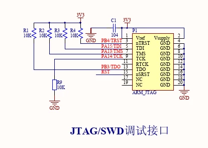

just see a "BlackPill" circuit, attached, for F4xx, this is what you want ;
a working st-link , you need then.
Just...not the full JTAG , only swd/swc is fine:

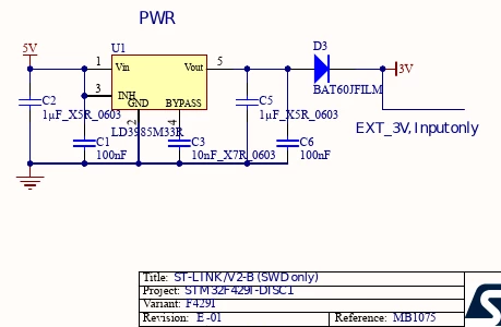

Where is the 3v3 regulator ?  USB -> has 5V , so how cpu is powered ?
harry123Author
Jul 21, 2024 12:41 AM UTC
  • It is powerd through USB same like stm32f429 disc1 board.
  • I want to replace with that with external power supply and debugger.Screenshot_20240721_060941_Drive.jpg

Jul 21, 2024 6:14 AM UTC
But its not in the circuit - i cannot see it...
like this:
on F429 is here 3V supply:
