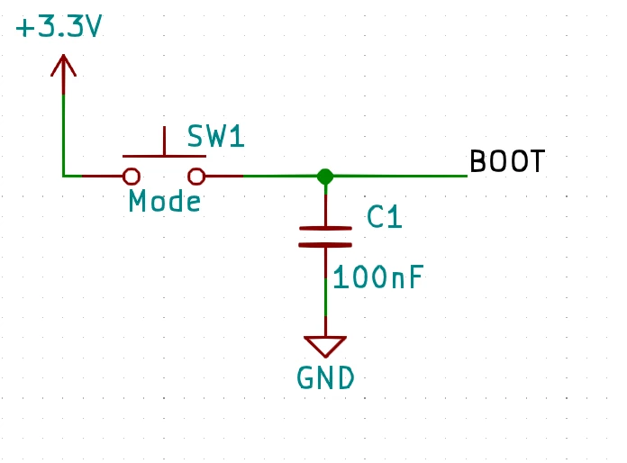

I have a custom board which always enters the DFU USB system bootloader when powering on, even though BOOT0 & BOOT1 pins are driven to ground. After I load a simple test program on it (via dfu-util), it runs the program just fine. However, when I remove power, it ends up back in the bootloader when I power it back on.
I've attached the schematic. It's based on another board design which works just fine.
I feel at a lost for why this could be happening. I've read the datasheet and the bootloader application note (AN2606). I've tested that the BOOT0 & BOOT1 pins are connected to ground. Is there another way that the chip could automatically go to the booloader and not execute the user program on power-up?

Is R2 really 20 Ω ?
Jeremy1
Jeremy1Author
June 1, 2020
R2 is actually 20k (that was just a typo in the schematic).

How is NRST connected? Is it really floating?
Jeremy1
Jeremy1Author
June 4, 2020
Yes, it's floating.

After playing with it some more, it turns out that replacing the pulldown resistor with a 100nF capacitor fixed it. (I figured this out after trying an RC circuit with it). I'm not sure if this makes sense to anyone, but that's where we are.0693W000001s9eMQAQ.png
