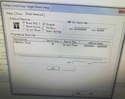

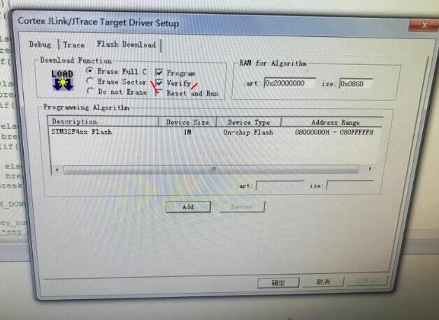

5. Simulator Connection Experiments:

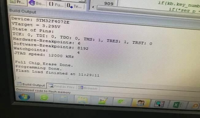

5.1 Without checking, the software prompt can erase FLASH and burn chips, but the program just can't run. Nor can DEBUG be online.

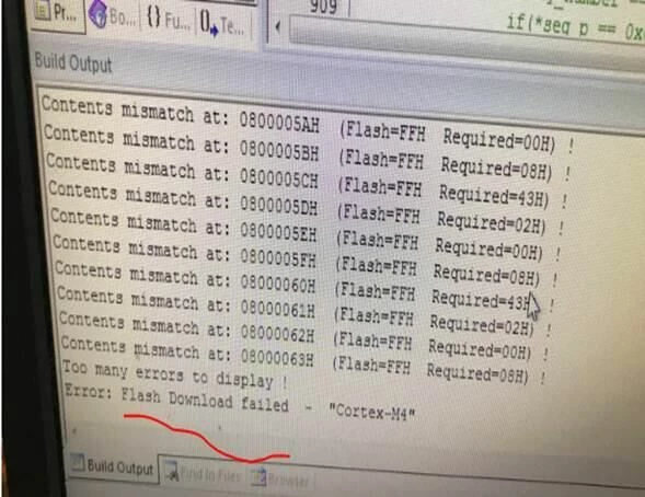

5.2 Check the case: Software prompt can erase FLASH failure:
Because the Flasher does not rely external quartz oscillators of the target. The MCU is started up with the HSI as clock source.

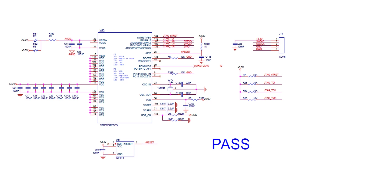

This is the design drawing. Please help me to analyze if there is any problem.

I am a software guy, my knowledge about particularities of hardware designs is limited. Hopefully, some hardware designers **** in.
Buffer caps for VDD seem there, and the wiring around the quartz looks normal.
As said, I would use a debugger, and verify if the MCU can properly start up clock tree from HSE. On a board that fails above mentioned procedure.
