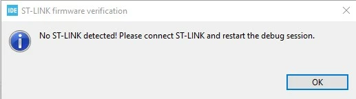

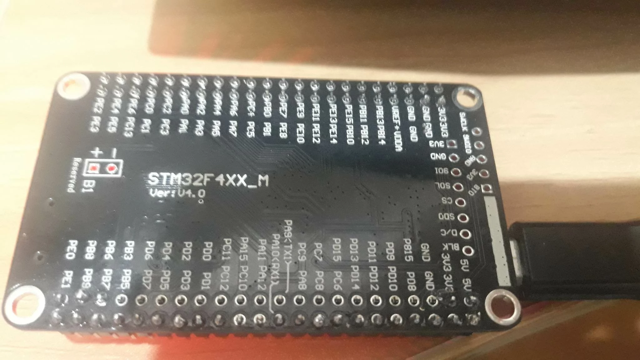

  3. after 1 week i finally got my STM32F407VET6 which has a mini USB. so i tried to connect it to my laptop. i tried to open a simple LED Blink but when i try to Run As or Debug As to 1STM32C/C++Application, it doesnt compile. it says "No ST-Link Detected! Please connect ST-LINK and Restart the debug session"

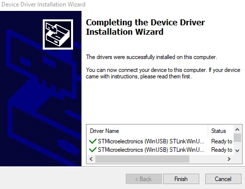

  5. ok cool. i downloaded both, extracted and tried them. first, i removed my usb cable then install Link009's file. just typical installation and everything seems ok 0693W00000aI68LQAS.jpg

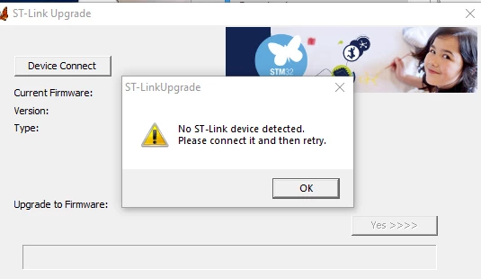

  6. now i tried to open the STSW-Link007 and reconnect my usb cable to my laptop. when i opened the STSW-Link007, this is where another problem kicks in: as you can see below it there is another error 0693W00000aI68uQAC.jpg
So im very confused. i can't progress at all. first there is no ST-Link detected in STM32CubeIDE and now to STSW-Link007. So i would like to ask. where did i go wrong? I've been doing this for 1 and a half day ever since it was delivery but nothing works. I highly appreciate any help. This is my first time interfacing with STM32 pheripheral so there might be something i missed....

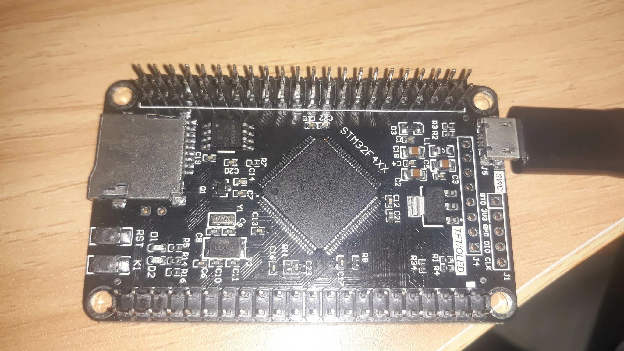

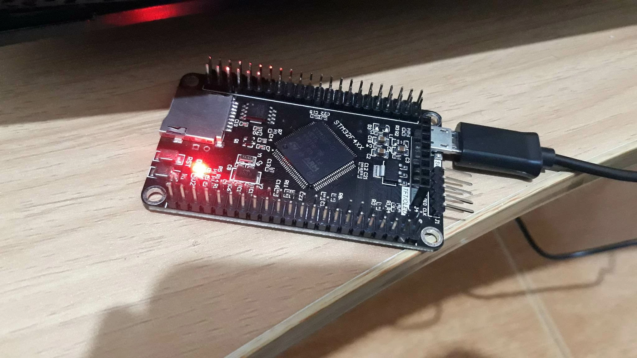

My STM32f4070693W00000aI6AMQA0.jpg0693W00000aI6AWQA0.jpg0693W00000aI6ARQA0.jpg

ST-LINK is a separate chip used for debugging. Seems that your board doesn't have it. Find the schematics of your board and try to attach a separate ST-LINK dongle. Or, easier: get a genuine STM32F4DISCOVERY or STM Nucleo board which already have it.

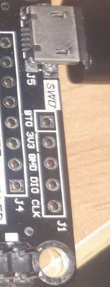

on your dev-e board is no STlink, you have it to connect here:
0693W00000aI8w4QAC.pngSWD connector: gnd, swd(dio), swc (clk) ; solder pin header here, connect to some debug probe : Jlink, STlink , ...

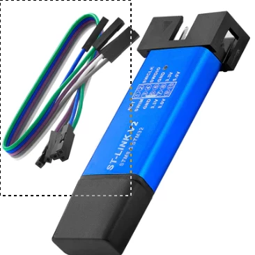

maybe some cheap clone:
0693W00000aI9AKQA0.pngor better :

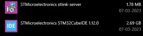

0693W00000aINCjQAO.jpg0693W00000aINFOQA4.pngI installed the driver from the st website still i get the same error. The " Getting started" steps are working, the tilting LED response and cursor movement when I connect both cabled to the laptop but when I go to debug my Target program of a simple "Hello World " the same error shows :"No ST- LINK detected.Please connect the ST-LINK and restart the debug session"

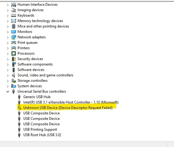

0693W00000aIMvUQAW.jpgWhen I do connect the board,Control panel shows the following change and this appears saying "Unknown USB Device(Device Descriptor Request Failed)" while the Board still has the running pre-loaded program of 4 LEDs and MEMS(if if push the button) meaning the power is reaching through my cable

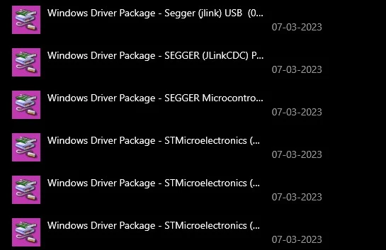

Things I tried:I uninstalled and reinstalled the drivers multiple times(tried the ones on website too-which are the same) ,Uninstalled and reinstalled the whole IDE and also checked by installing in different drives (C & D),Checked Hardware and Devices troubleshooting,Updated Windows, Tried to provide the driver location to the above highlighted Unknown USB Device driver to the location where drivers are of STSW-LINK009 etc

First, check that your ST-LINK is not damaged.
Disconnect it from the target and connect (the USB end, of course) to some other good PC.
It does not matter if ST-LINK driver is not installed there (or you don't know) - do not install anything.
Open Device Manager and look for the ST-Link there (even if driver is not installed, it will be visible under USB devices). On Linux, use sudo lsusb.
If not visible, or "Device Descriptor request failed" - try to replace the USB cable and/or connect thru a powered USB hub.
If nothing of this helped, your ST-LINK likely finished its useful life.
​Otherwise, connect ST-LINK to the target and check again. Still alive? Great, move it to your work machine (where you have installed the drivers and the rest of tools).
If you see "no ST-LINK detected" now, this should be purely software issue.
This includes refusal of new ST tools to work with fake ST-LINKv2 copies.
