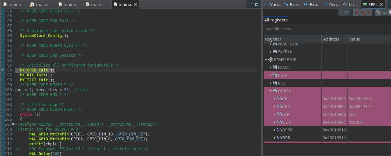

I need support with the following issue I am facing.
I am using the discovery board STM32F407G-DISC1. When I launch the debug mode, in the SFRs window I get the error "Error reading value".
I am following a course in Udemy for embedded programming using this specific board. Debug mode worked fine until now (implementing GPIO drivers and Interrupts).
To try to issolate the problem, I came back to a simple program from the begining of the course to turn on the LD4. This program was working fine with the debuger, but not it is not.

1. ST-LINK Utility is old, deprecated. dont use it.
2. SFRs window : you can see values only while stop/pause debug , not while running program.
