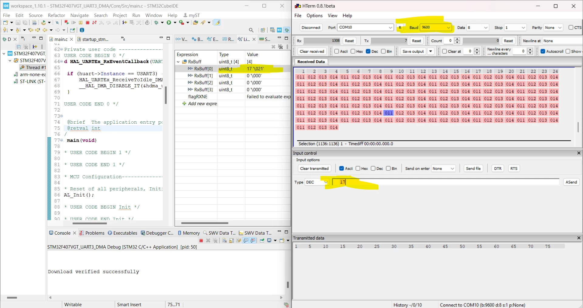

I'm using STM32F407, use usart3 set DMA setting baud rate 9600 and use receive
void HAL_UARTEx_RxEventCallback(UART_HandleTypeDef *huart, uint16_t Size)
if (huart->Instance == USART3) {
HAL_UARTEx_ReceiveToIdle_DMA(&huart3, RxBuff, Size);
__HAL_DMA_DISABLE_IT(&hdma_usart3_rx, DMA_IT_HT);
connect to computer using software terminal "HTerm"
Set baud rate 9600 STM32F407 can receive
But i change to other baud rate such as 115200
then i change baud rate 9600 can not receive
TatoBest answer
January 15, 2024

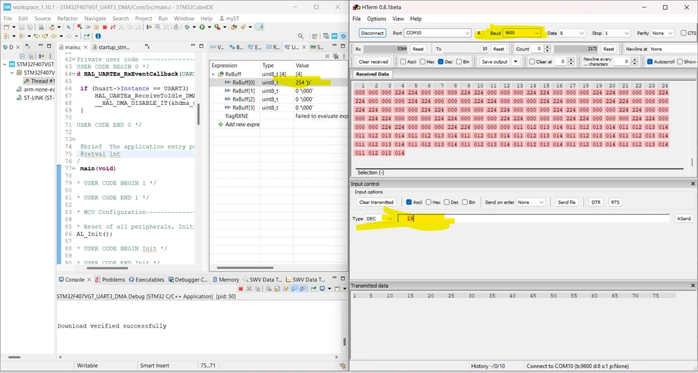

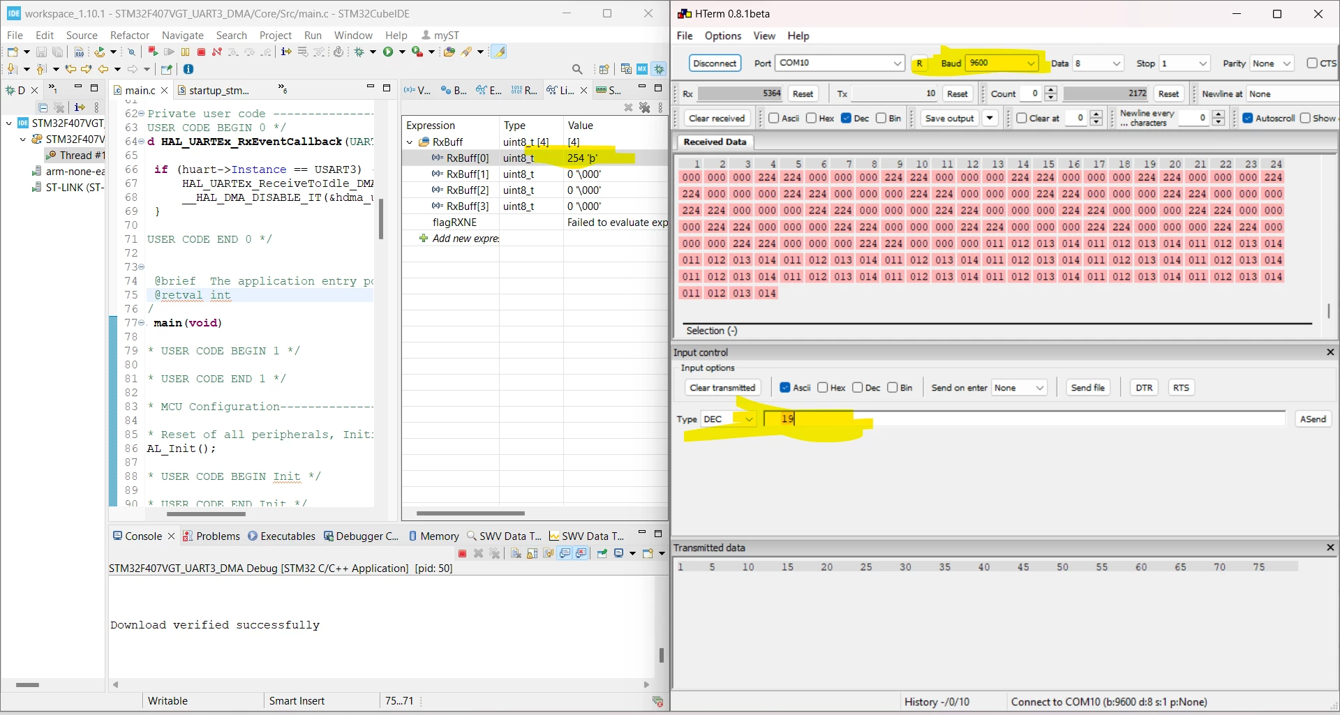

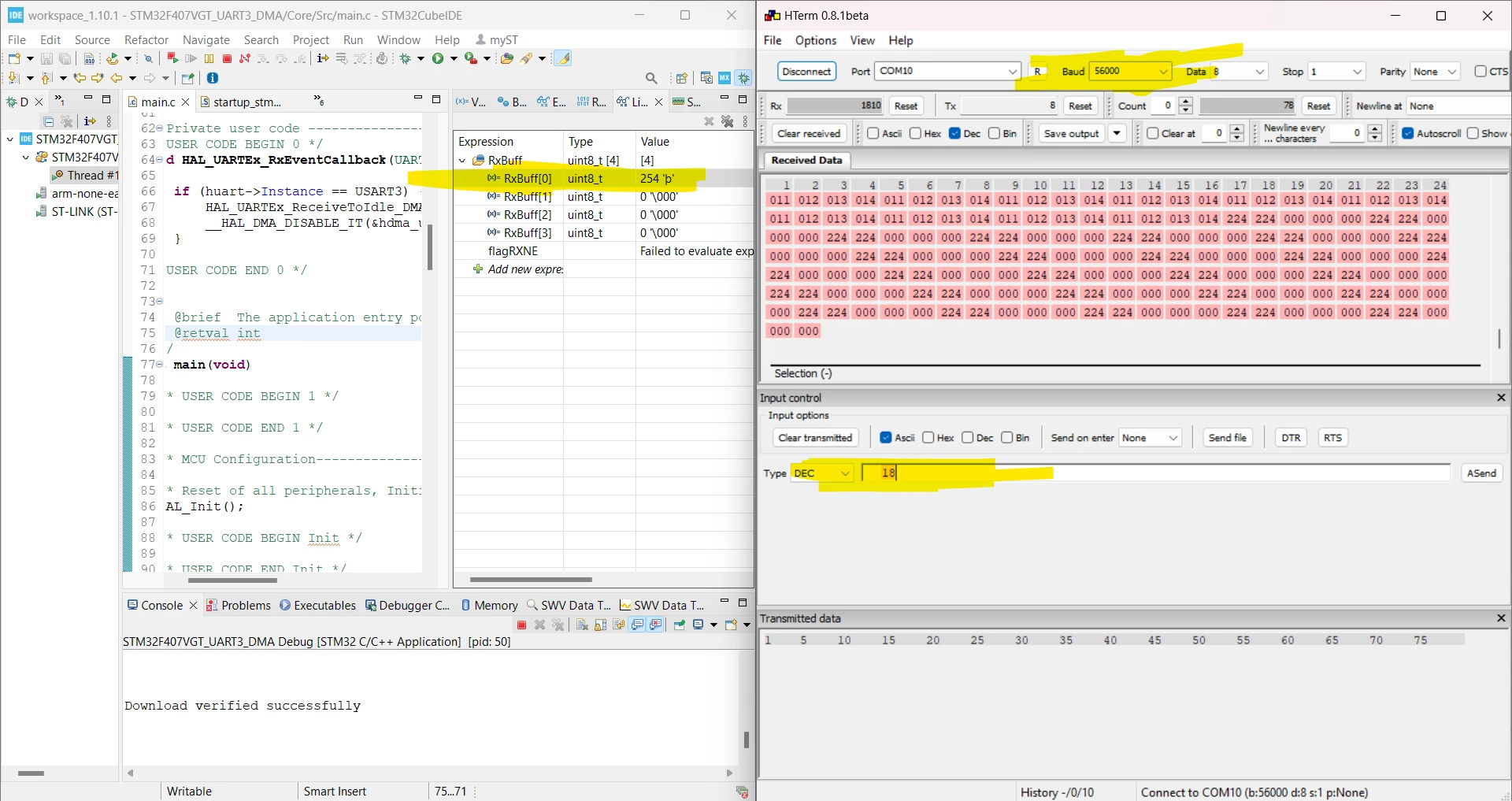

1. Setting baud rate 9600 HTerm is working
2. Setting baud rate 56000 HTerm is working
3. Setting came back  baud rate 9600 HTerm is not working

Check if you have any sticky errors in the status register that need clearing.
ie noise, framing, parity, overrun, etc
