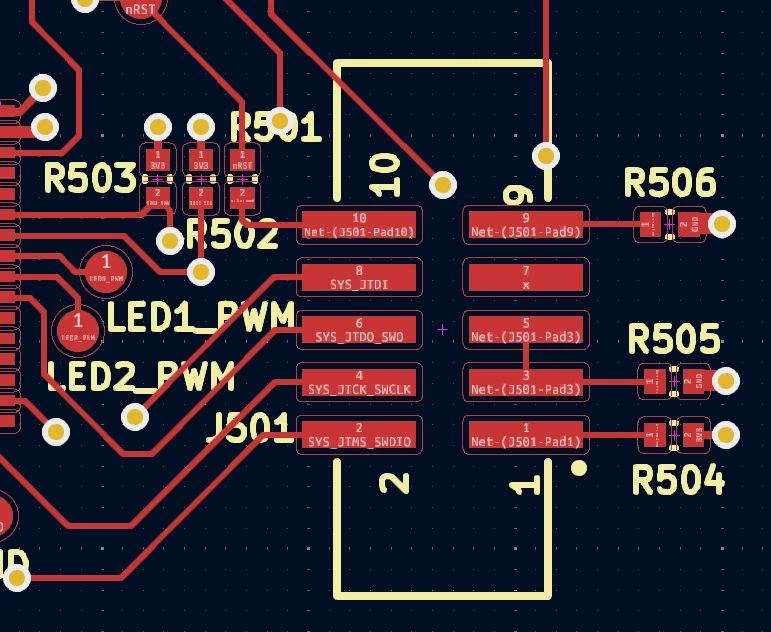

For some reason I am unable to connect to my custom STF32F405RGT6 board via SWD or JTAG.

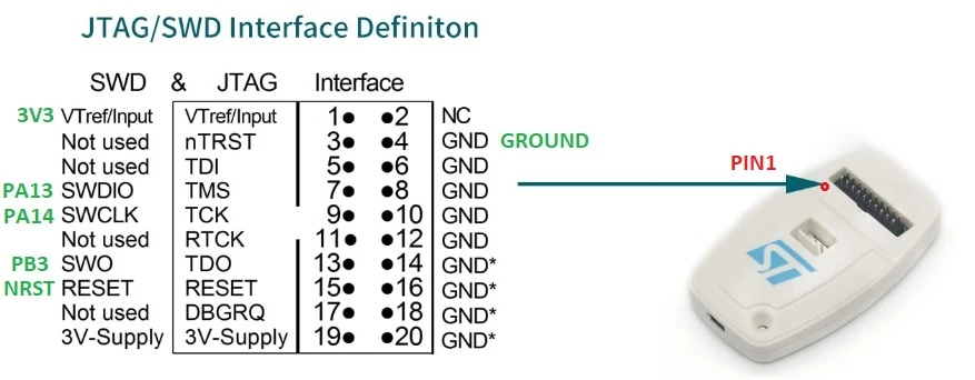

I originally had my board wired as this table below:
ST-LINK/V2ST-LINK/V2My BoardMy Board
Pin NumberConnector CN3MCU PinMCU Pin
1Target VCC
2Target VCC VCC
3TRST
4GND GND
5TDIPA15TDI
6GND GND
7TMS_SWDIOPA13TMS
8GND GND
9TCK_SWCLKPA14TCK
10GND GND
11Not connected
12GND
13TDO_SWOPB3TDO
14GND
15NRST7nRST
16GND
17Not connected
18GND
19VDD
20GND
This is from the ST-LinkV2 documentation Table 4: https://www.st.com/resource/en/user_manual/um1075-stlinkv2-incircuit-debuggerprogrammer-for-stm8-and-stm32-stmicroelectronics.pdf

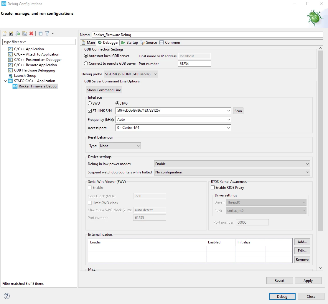

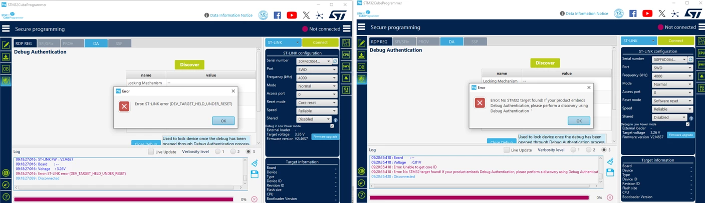

I have tried both SWD and JTAG with all possible reset methods through the CubeProgrammer and IDEDebug configuration:

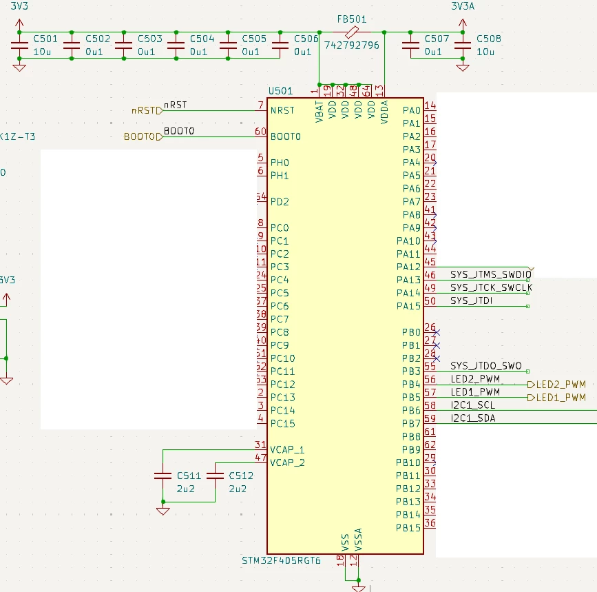

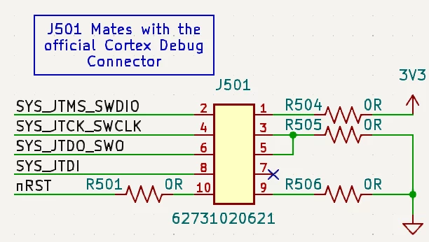

My schematics look like this:
I have 3V3, 3V3A up and measured as 3.26V on my multimeter, and VCAP is at 1.2V.
I tried both versions (high or low) of the BOOT0 pin and saw no difference.
I kept getting one of these two errors:
I then removed R501 and still saw these errors.

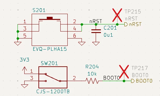

I also tried a few variations of pulling nRST high or low, as well as PB4 high or low, or even connecting PB4 to R501 which would allow the nRST from the STLinkV2 to be connected to TRST of the STM32.
Why am I not able to communicate through this interface?
Best answer by Parker
Hey! Its working! My push button was holding the STM32 in reset because I accidentally rotated it 90 degrees during assembly! I reconnected the nRST pin to the JTAG header and am able to flash my blinky project! Thank you everyone!

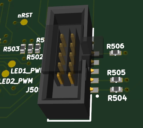

Part not viable?
Pin header mirrored?
The 1.2V on VCAP suggests the part orientation is good. Schematic look Ok.
Picture of board, with debug header and ST-LINK attached? To see if anything obviously wrong there.
ParkerAuthor
August 14, 2025
Thanks for the quick reply,

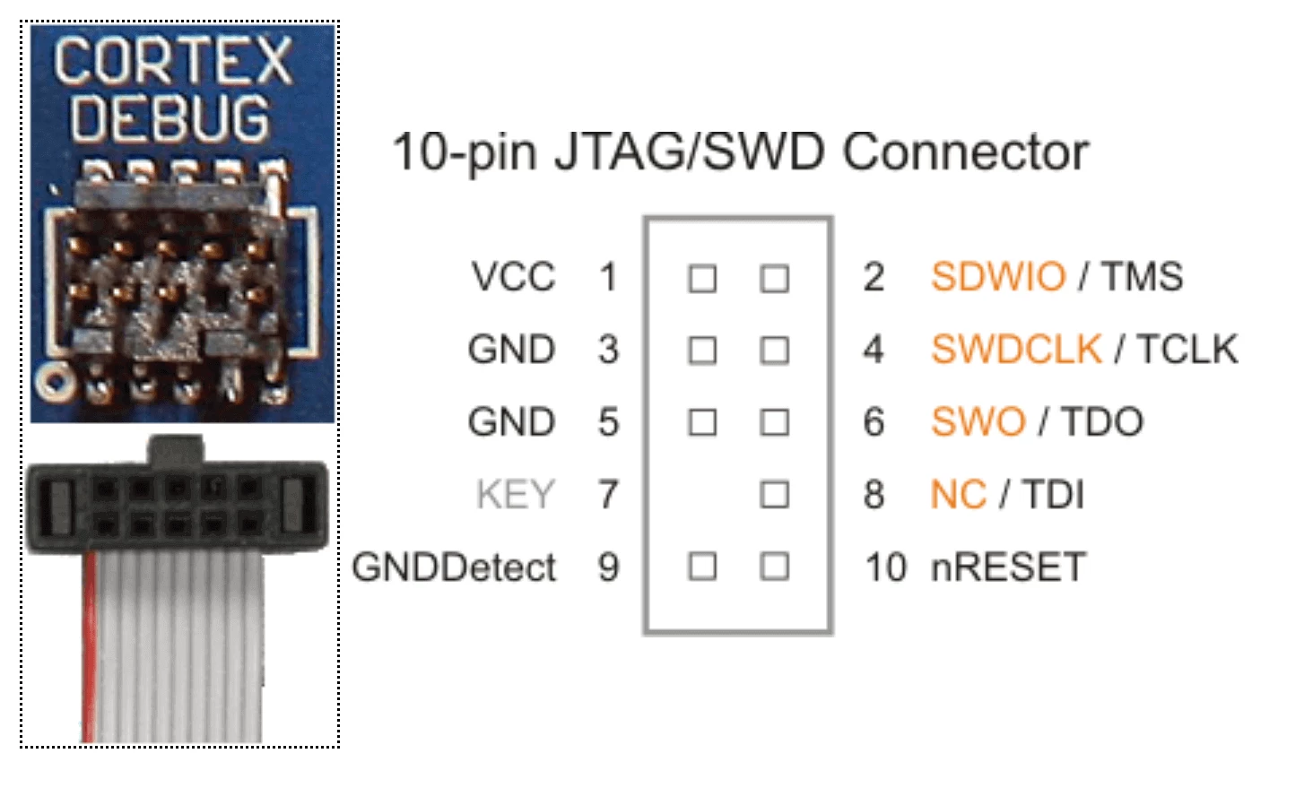

On your 10-pin JTAG/SWD connector where is your nRESET signal routed? Pin 7 of the STM32 or Pin PB4? Does this matter?
I can confirm that the pin header is not mirrored or rotated improperly:
The key is on the same side as pin1.
I checked my wiring from ST-LinkV2 through to the board. I am using CN3 on the ST-LinkV2 through an ARM-JTAG-20-10 to my board with no hacks or modifications to those wires.
Any other reasons?
Tesla DeLorean
Guru
August 14, 2025
Not sure why you're involving PB4  the NRST/NRESET Pin 7 of the STM32F4 looks appropriate
Make sure you've identified Pin 1 correctly, one of you screen shots reports 0.01 V, so no power to buffers there.
